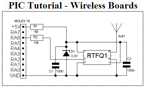

zener diode in RF circuits
May i ask how is possible to connect a zener diode without having to replacing it (explodes) every time 5V passes through it???
Im trying to connect a 3.3V zener diode in series with 68 Ohm resistor in a circuit supplied by 5V (as shown in www.winpicprog.co.uk , in pic tutorial wireless board) However my diode overheats each time im trying to connect it to 5V.
5V doesn't pass through the zener diode. The 68 ohm resistor in series with the zener diode limits the current in the zener diode to only 25mA. Therefore the zener diode heats with a max of only 3.3V x 25mA= 82.5mW.
You probably have the 3.3V output of the zener diode connected directly to 5V, so the 68 ohm current-limiting resistor is shorted.
exploding zener diode
"You probably have the 3.3V output of the zener diode connected directly to 5V, so the 68 ohm current-limiting resistor is shorted."
Well yes that's what i ve done....ehm ok i ve connected both ends of 68 Ohm resistor along the Stripboard's track line.... and the diode was indeed directly connected to 5V.....
The zener diode is not supposed to connect directly to 5V. It is supposed to have the 68 ohm resistor in series with it to limit the current.
Here is the schematic:
Nigel Goodwin said:

audioguru said:
