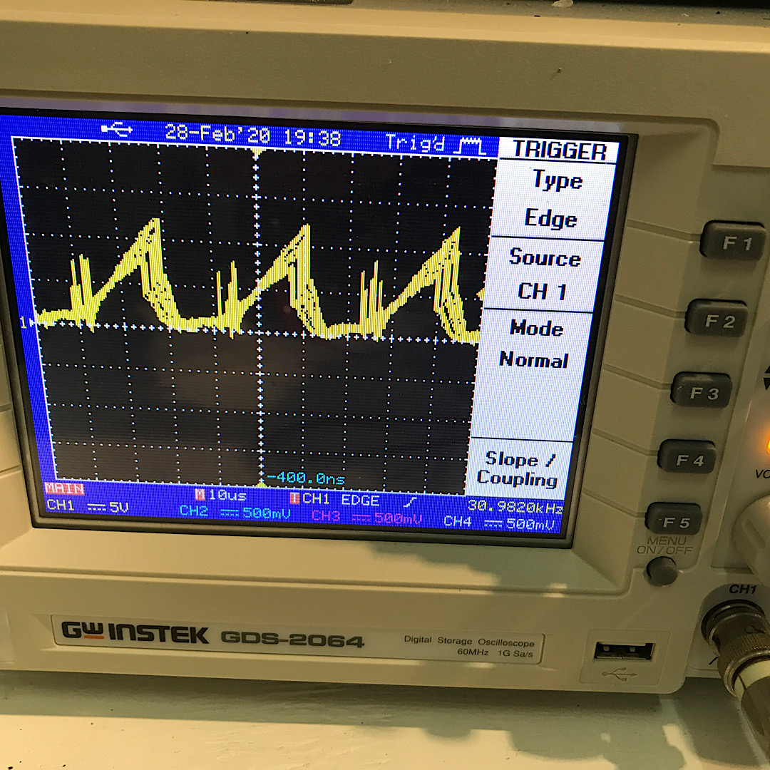

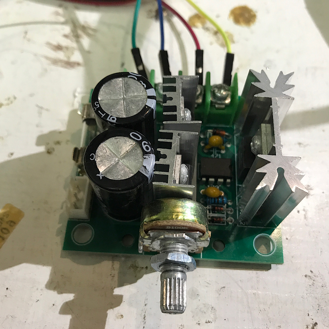

Might be I bought a really cheap (and probably crappy) pwm motorcontroller from China. I hooked it up to my scope and got some very strange reading. There is also a possibility that I’m doing something really stupid with the scope cause I’m pretty green at this ;)
The motor is running ok and the speed control works. I’m just very curious about the strange waveform. I expected it to be a square wave.

motor windings act like inductors, so when a pulse is applied the current ramps. it's the same effect as in a CRT monitor deflection yoke.
Oh, thanks! So I guess we’re looking at a noob mistake here ;) At least I learned something new.

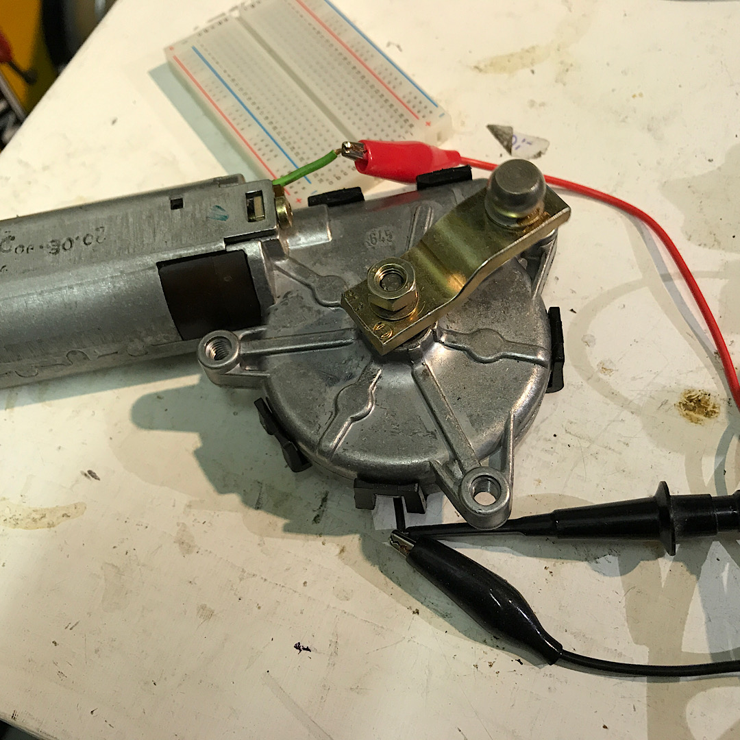

Could you please tell me what might be the correct way of hooking up the scope?
Thanks a lot for helping me. I really appreciate it! I thought the LED would be the same. I’m learning a lot here :) And you are correct in the assumption of a car motor. It’s a wiper motor.

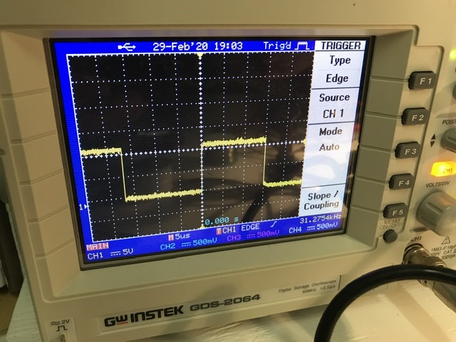

Over the years I've found car bulbs an invaluable source of 'dummy loads', a combined rear/brake bulb gives you three possible loads, and for higher loads a front fog light bulb or headlamp bulb does the job nicely.
that’s a really good idea! Will be getting those to have some options. I had a small 12v rear lamp and...success!
