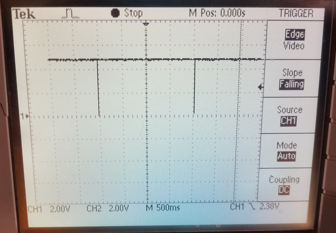

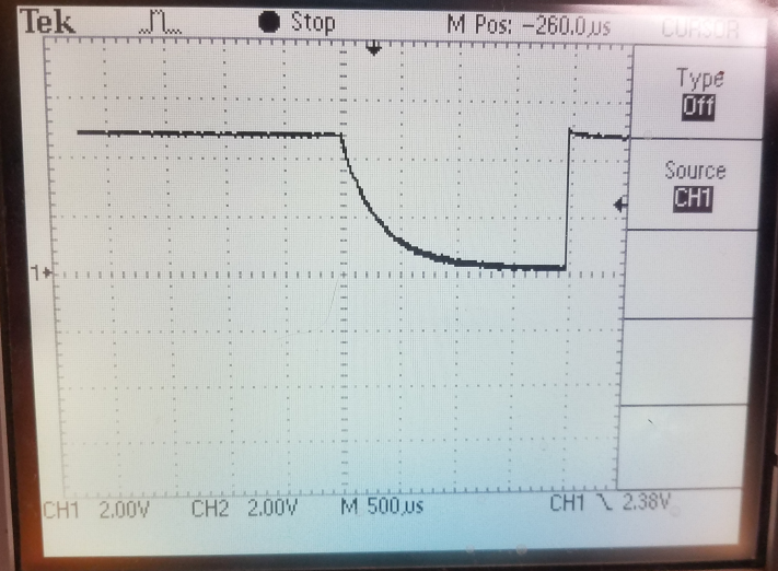

Here is a strange one I can't quite seem to pinpoint. At first I thought it was the Watchdog timer, and then possibly an Interrupt, but neither one of those seem to be causing a 2ms pulse every 2 seconds.
I have reduced the code down to a bare minimum and still see the issue (See scope images)
Also moved the power supply to battery power and it is still present.
Any thoughts would be welcome

Nothing else connected ... I program with a PICkit 3 ... but I removed it from that. It's just on a Solder less bread board right now. I was doing some proof of concepts for a project and noticed the behavior.

I just programmed a second micro and it's the same thing. All I have is power and ground connected... scope is on pin 5 with a shared ground. Scope is galvanically isolated.

Something wrong here. The LF series is supposed to run 2.0 to 3.6V according to the datasheet, but your scope captures show 5V P-P.

Dang, I thought you might have been onto something I missed. I lowered the voltage to 3V and then to 2V on a 3rd micro (to make sure I didn't damage it in the first two attempts) and still observe the same behavior.

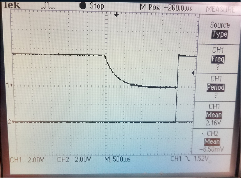

Mike, it does actually go into reset (See attached image Channel 2 shows the reset)... Mike, I'm certain it isn't going into reset ... I modified the code just before "Main:" slightly, so that an io pulses HIGH then LOW at the beginning
So why does this code go into reset? Three different micros, and I changed the position on the SBB. There are no shorts, and there is a 10uF cap across pins 1 and 8

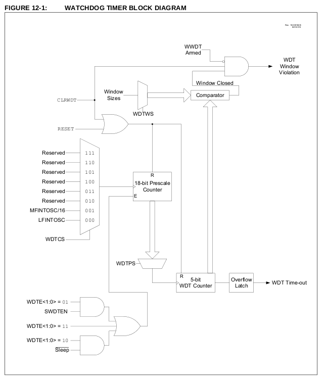

What happens if you add a watchdog reset in the main loop ??
It could be some kind of device but that means the watchdoc is not disabled when it should be..
SOLVED!
The problem is in the WDT (Watch Dog Timer)
Upon a reset the micro goes into a low speed mode and enables the WDT regardless of what you set the configuration bits to.

Even if you enable the SWDTEN (Software Watch Dog Timer Enable) from the configuration bits, it still seems to have no control
programmatically from the WDTCON0 register to disable it.
    banksel WDTCON0
    movlw   b'00000000'
    ;         XX...... Unemplemented
    ;         ..XXXXX. WDT Prescale
    ;         .......X WDT Software Enable
    movwf   WDTCON0
The "SOLUTION" I found was to set the WDT clock source to any of the 'RESERVED' sources so it simply doesn't increment.
I don't like pointing to a reserved location, but I can't find any way to programmatically dissable the WDT after a reset without having to feed the WDT with a CLRWDT
