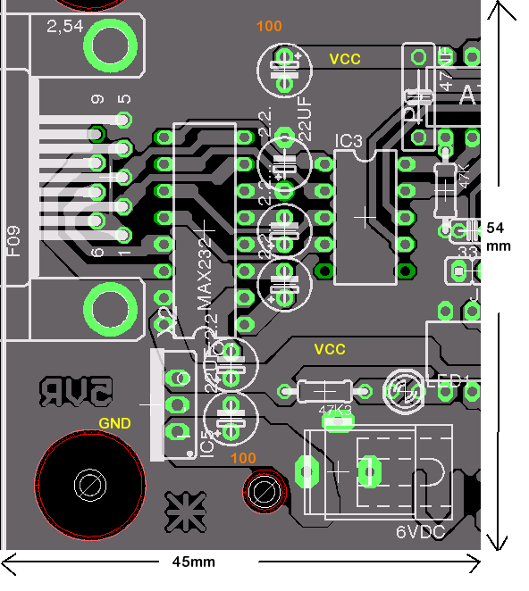

This is my circuit as laid on a PCB. Mot of the time the VCC (5V) is next to the ground plane which I believe increases capacitance between the two sets of copper. I have the capacitors arranged so that the input and ground is connected via capacitor and the output and ground is connected via capacitor. both are marked with orange 100 meaning 100uF/16V.
I also provided measurements so you see how close the parts actually are together (example: actual distance between jack and capacitor... 4.5mm) The bottom-left component with a thick white line is the regulator with the back side facing left.

The MAX232 should have a capacitor from VCC to GND, at the IC. That is not your problem here.

What is on the reset pin on the micros?
But isn't it (input - output) * amps? so 6 - 5 = 1 times 1a = 1W?
and for reset, I use 47K resistor with 47nF capacitor so reset wont take forever. I've seen designs with 8K resistor and 10uF capacitor but I don't know why they want such a long delay unless its because of their crystal
