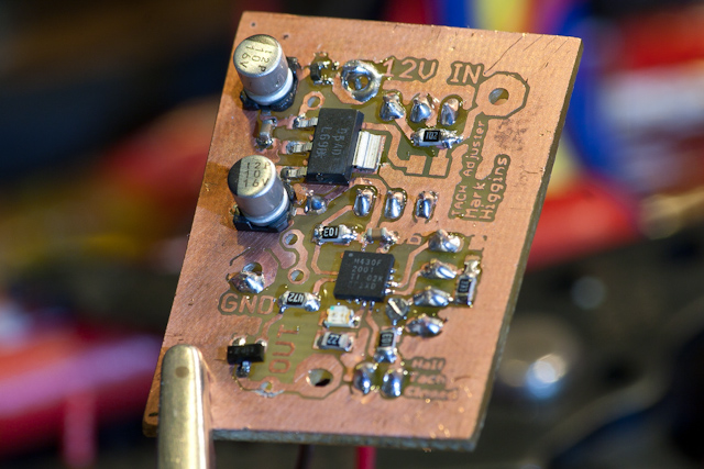

If you can use a copper fill with your PCB layout it significantly decreases the amount of etchant you need to use.
Are you drilling from the top or the copper side? It looks like the top from the picture. If you drill from the copper side the copper will guide the drill bit a little bit. Like mentioned earlier you can decrease the hole size in some of the PCB package which helps guide the drill bit better..
I drilled from the copper side, but like i say with the paper imbeded in the toner it looks funny. thats why I finally cleaned it with acetone just to see if all was well below.
If you can use a copper fill with your PCB layout it significantly decreases the amount of etchant you need to use..
I don't understand what you mean.
I'll usually use the copper for text as well. If you have such large components and empty space you might as well put text labels in your copper.
OK, I have seen that before and I was going to ask about. In fact I was just thinking about that as I was etching because it was taking a long time and the Ferric Chloride was getting weaker with each board. I thought maybe next time I would leave some of the copper so that there would not be so much to remove.
