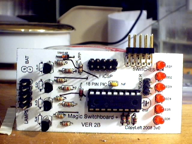

In Eagle there is a ULP called center drill that fills all the drill holes on the artwork. It leaves a spot in the center just large enough to help position the drill. With it you always have copper to the very edge of you hole even if you are off.

As some of you know I have the use of a CNC to drill the holes. I drill then etch with toner transfer
