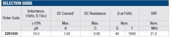

What is the current rating on the inductor you are using? (saturation current and DC current)
Below is inductor information for inductor I have now.
I actually tried few different SMD inductors as well with 10Amp rating - same result
