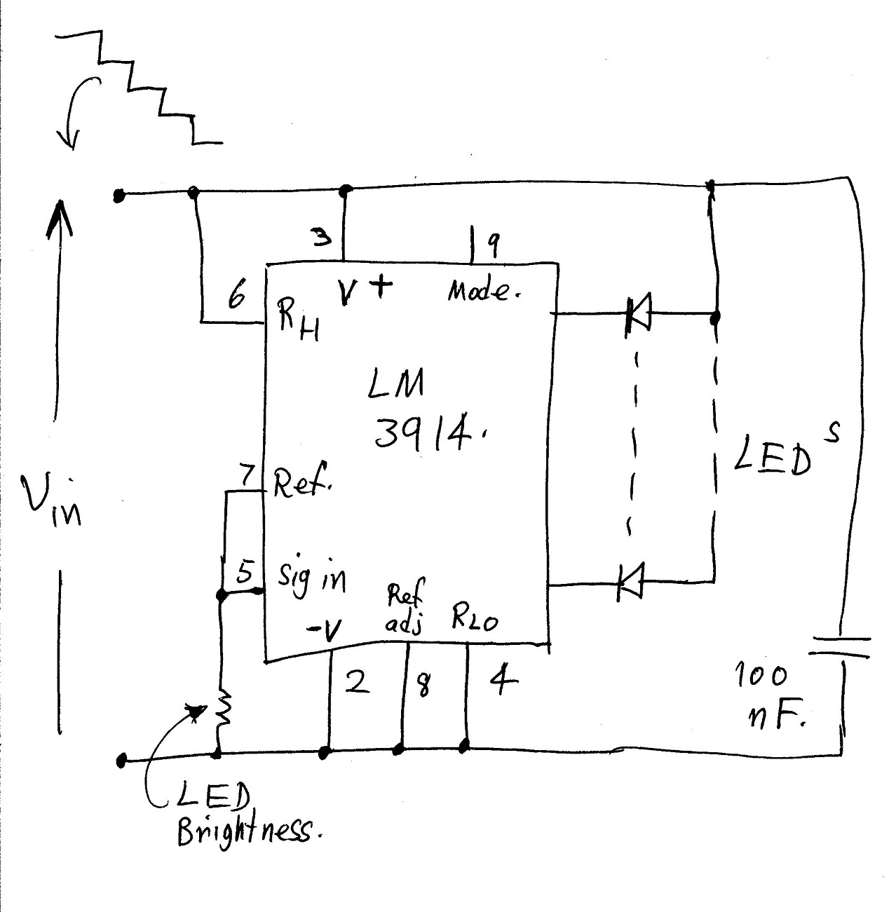

Consider the use of a LM3914 in the dot mode. That will give you as many as 10 voltage dependent outputs. One chip package. Then to drive the lamps use single transistor drivers.

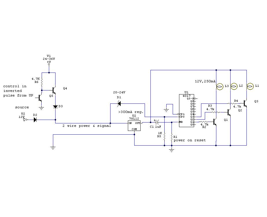

Here's a design challenge for you all (and me).
I have a series of status lights (four currently, but might be three to six) that I would like to illuminate, one at a time, using two wires, and as few components as possible. There is no order to the lights so a counter would be out.
The driver behind the attempt is to reduce the conductors required in the cables and connector to reduce cost. But too many components in the solution may increase the complexity while not reducing the cost.
My first thought was select the light based on the voltage supplied. I can get two lights if I use a positive and a negative voltage, but that diesn't get me in the 3-6 count required. I also was pondering a zener ladder, increasing the voltage to trigger the next light, but all the previous lower voltage lights would also be on. No go there.
I look forward to seeing what you all come up with.

see the attached circuit, it may work for the purpose, but you should have the right controller at the end to signal the pulse depends on the last status displayed.
in 3 lamps system, say if lamp 3 is on then to make the lamp 1 "on" it may require 8 pulses or less depends on if a reset also wired.
you can select the transistors & regulator depends on the power handled.
Edit: another way to set the lamps without memorizing last status, just make a power off at every time before sending a pulse train to set the lamps, it will reset the counter & make the counts from start.

All the digital and PW solutions so far violate the "power over the same two wires" requirement.
Your circuit meets the two wire requirement. After LJCOX post I could picture where you were headed. Instead of the resisitor-transistor pairs, I would opt for a ULN2003. They are wonderful chips for dealing with logic-driving-power circuits.
I wasn't thinking digital when I started the thread. You have all put up some nice options. Unfortunately I would need to device a way to send the pulse count.
I'm hoping to play with SPICE tonight and see if I can figure out how to turn of the preceeding lamps. I think it will be some type of cascade circuit. Such that when Vsig > Z2 it activates a transistor that shuts off the light attached to Z1, then when Vsig > Z3 it activates a transistor that shuts of the light attached to Z2 and Z1.

The 4017 circuit lets you turn on one lamp at a time. I thought you needed independent control of each lamp, which means that if you have four lamps, there are 2^4=16 different states of lights being on/off.
I follow you now Mike. Actually I didn't say. I believe that only one lamp will be lit at a time. I will need to review the requirements and see if I need to light two specific lamps at once. My initial train of thought on the design would only light one specific lamp at a time.

Here is another thought.
Use the LM3914 "in reverse", ie. connect the stair case voltage to RHI and the Sig in to Vref.
The spec indicates that RHI can be connected to V+ & I can't see any reason why you can't connect Sig in to V ref.
