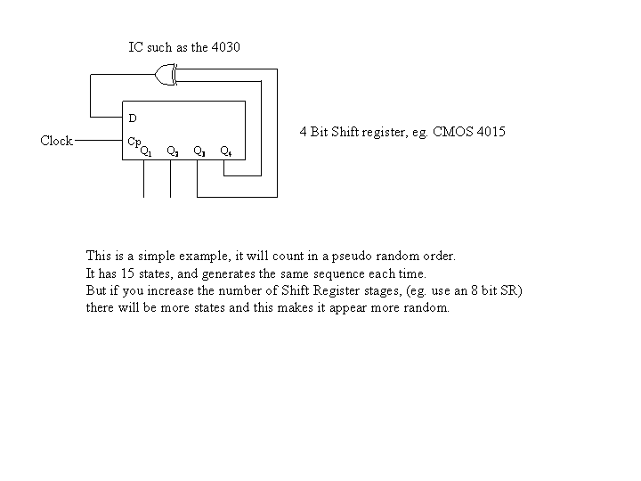

What about using a pseudo random counter - see attachment.
Do you want to be able to control the times that the lights change?
Or do you want it to be free running?
You would need some gates to be able to turn on each light individually.
The pseudo random counter can be made longer or shorter.
The 4 stage shift register will give you 15 states.
So, for example, if you had 5 lights, then the gating could be designed such that light 1 is on at counts 1, 7 & 11.
More states will make it appear more random.
If you want to be able to control it from the supply end of the 2 wire connection, then you could apply some type of modulation on the DC.

These are status lights. The main controller will dictate which light is on. They don't get to choose at random.
In that case, then you would have to modulate the DC with coded pulses.
eg. a long pulse to reset the counter or shift register and short pulses to step it.

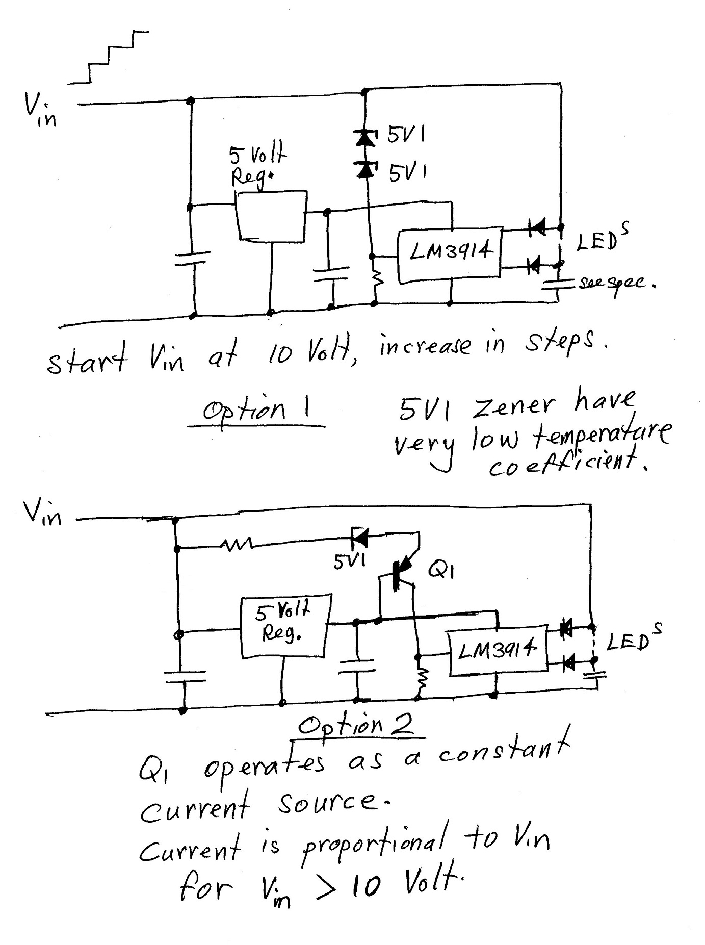

For an analogue solution, you could use the LM3914.
I thought of that, but the IC is not tolerant of changing the supply voltage with the signal voltage. I only have two wires, unless I find that it just can't be done.

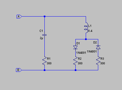

Without too much thought, here is how you can do three. R1-3 are 12V grain-o-wheat lamps.
If you feed A-B with +12Vdc, you light up R2, but not R1 or R3
-12Vdc, you light up R3, but not R1 or R2
12Vac at >1kHz, you light up R1, but not R2 or R3
12V square wave at ~50Hz, R2 AND R3, but not R1
and you can get the other combinations (8 total) by independently controlling the AC source and the DC/squarewave source.

See attached. You may have to vary the step size as the voltage increases to account for the increasing voltage through the Zener(s).
I have drawn the basic idea, some other components will be necessary as per the LM3914 spec.

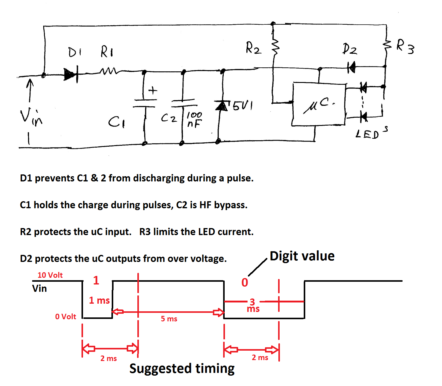

Here is a suggestion.
A microcontroller (uC) would be a simple solution see attached.
