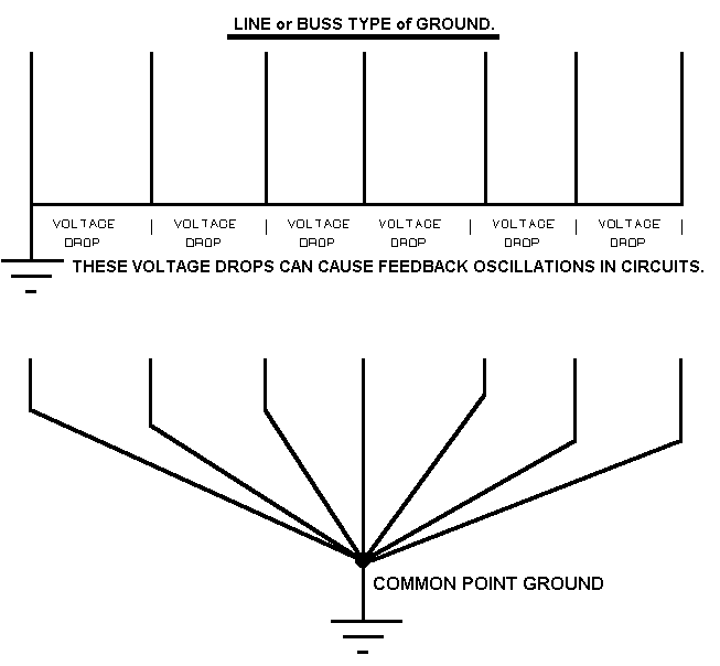

I didn't read the data sheet fully, but what you have is a high current system and a low current system. The high current system is "less tolerant" of the voltage drops.
So, what we can do is create different ground busses in our system depending on like characterisics.
A. A digital bus could have lots of switching noise on it
B. An analog bus needs to be clean. i.e. reference voltages.
C. Motors with high current and pulses.
D. Chassis
E. Earth
So, you separate all of these and connect them at one point. You can also "isolate/filter" them a bit, but I won't talk about that,

A "Star Ground" or "Common Point Ground", Eliminates Tiny Voltage Drops that can happen between Various Ground Points.
