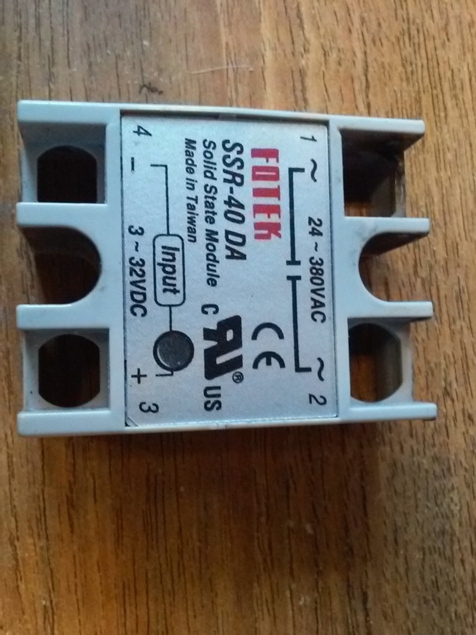

Hello, new here and just retired, so have time now to play, still broke but have more time, funny how that works.
Anyway, have been doing metal casting for a few years and the kiln works fine except for these FOTEK SSR relays I buy, Its a big pain the have a relay burn out in the middle of the operation, just like what happened again this morning.
Was reading about fake SSR's and thought I would carefully take this one apart.
Its a 40amp, thats what I have been using for my 120v-1400 watt kiln.
I'll post some pics here but the triac has this # on it, (BTA16, 1000, B, 41, 139)
If I did my research correctly it is a 16 amp part, not a 40 amp as the relay says. Am I Correct?
I enjoy building stuff so I was thinking of building a SSR, one that I could depend on.
I know I could buy on, but the point is the building is the satisfaction of doing it myself.
I have a schematic here (https://www.theprojectasylum.com/electronicsprojects/triacssrelay/triacssrelaycircuitdrawings.html) and the capability to make printed circuit boards
Any input would be great..

Another thing to consider is that the cold resistance of your kiln heater could be much lower than you think at the instant you first apply power, so what is killing your SSRs is the in-rush current surge.

There is really no set occurance as when they burn out, the last one was just when I was ready to pour, about an hour from start to finish, others were at any time that I recall.

Surely the point here is that a BTA16 is indeed a 16A triac, which has no place in something claiming to switch 40A. So I suspect that the OP is right, and that these SSR modules are fake.
