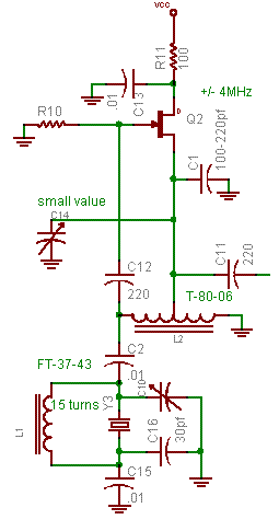

Ya know, I never had any luck trying to warp that crystal frequency down. Amazing! I can warp it up at least 5KHz and it remains locked by the crystal. The second I attempt to go below the frequency it grabs the natural frequency until I rotate the capacitor so far past, it will jump way down. Then I rotate it back up and as I approach the crystal's natural frequency You can look on the scope and see it phasing out where it looks like it is producing the crystal's natural frequency and a few other freqs in between the LC frequency.
Must be the cut.
May have to back up and do PLL.

Anyway, I'm phsyched!!! I got the VXO to go under frequency with no phase noise. I can touch the variable capacitor metal shaft and the frequency does not move. The crystal is at 4MHz and right now I got it set at 3.985MHz solid! I only need to go below frequency by 1.5KHz and then run it through the crystal filter I made with two 4MHz crystals. So, 3 crystals on the same freq will do it. Cost about $1.50...lol

I'm happy for you that you were able to pull the xtal down 15khz at 4mhz. I'll try to remember that. You put a cap across it? What value? Any inductor involved?
When I read your post above I missed the fact that you were repairing Motorola HT's and pagers. I was too much in a hurry to post :) Lucky for us it was Motorola. I saw some other brands and they seemed like junk in comparison. GE, RCA. I guess things are much different now. I had those codes and freq. that the DEA used. Never did anything with them. I never saw a HT400. Guess it was after I left that job. HT330 was the last one for me.
Yeah I had ballance some parallel capacitance with about 22pf and give it al little more feedback.

I wanted to see what I could get away with because I noticed if I get too close to the crystal frequency it might jump back on the Xtal freq. Possible loading could cause it. It looks as if it should be exactly 1.5 KHz or very close to it. I think I'm ready to put the chip in...the MC1496. If this goes well I should be close to buzzing this thing out! I got some old amps I built years back and hooked them up and did some CW QSOs. After a few bad signal reports I cleaned up any rf leaking back into the circuit from the antenna. The hams will tell you, you got a problem in your power supply...lol. It does make the same hum sound you would get from poor filtering. It was crazy too. I got a 2-way antenna switch to switch from transmit to receive and i guess it was the cause, but what happened was, I was running the receiver off an old power supply I built into a plastic tool case so of course no shielding there but it was only the receiver. So what I suppose happened is the rf leaked through the antenna switch back to the transmitter modulator which at the time was an old PLL that generates various frequencies on the 40 meter band. I put a regulator on another power cable and ran it off the same power supply as the transmitter and it cleared it up. The power supply is mucho clean. A Kenwood I picked up at a ham fest. So everything works. I got about 75 watts out and it is clean. So all I will need is a nice modulator signal and about 1/2 watt to drive the two amplifiers and I'm talking!

Anyway, here is what I ended up with:

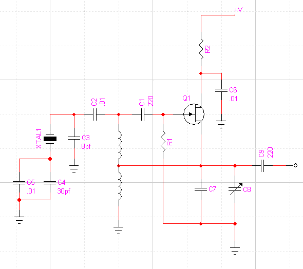

I looked at your circuit and decided to redraw it to make out what you have going on. See attached.
I can see why your unable to pull your crystal as your varicap is hanging on your output. Not sure if taking output off the feedback path is a good idea as the next stage will cause loading and detuning. What value cap do you have in parallel with the varicap?
I am not sure why your hanging a .01 cap in parallel with a 30pf cap on one side of your crystal. This would seem to put a rf ground on the one side of the xtal so the 30pf is useless.
I thought for a hartley osc the crystal should be in the feedback path, not shunt, but then again I do not have much knowledge in osc design.

Those are good questions. In oscillators it is the AC feedback path that determines the type of oscillator it is. Most people automatically assume if it has a crystal, it is a Pierce oscillator. Not so. So the Hartley gets it positive feedback off of the tap on the coil. The .01's are just coupling caps, like AC shorts. The small value capacitors to ground are to cancel out the parallel capacitance of the crystal. Understand they are frequency responsive. Sometimes when filtering potential rf from the power bus or other parts of a circuit, it is necessary to use two or thee different values to capture all of the rf/ac interference.

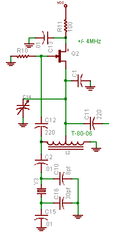

It works very well, but the only draw back to the circuit is, when I turn off the power and turn it back on the frequency will jump above the crystal frequency approx 27 Hz. So I have to retune it each time I restart the oscillator. But it does remain locked once set, until power is cut again. I have used heat on it and squeezed the variable cap and it stays on freq. So I will have to watch the loading. I assume this chip has a good input buffer.
Actually I take it back. I can get it to come up locked below crystal frequency. I replaced C10 with a variable cap. It turns out to be a balancing act between c10 & c14.
What is so tough about it is getting it to remain stable at such a close frequency to the crystal's natural frequency. It is spec'ed at 1.5KHz from crystal filter. I'm attempting to use 3 or 4 crystal of the same frequency for the whole set up.
Got a final update...lol.
Now I feel secure in proceeding. What it would do orginally is warp up in frequency but was very difficult to get it under freq. I had tried series inductance but over looked parallel inductance. Turns out to be the ticket. It will now fire up right on frequency, has the most beautiful sinusoidal wave-form and when you tune it it now does not want to go to it's natuaral frequency but will stop right before. Or what the frequency is, is 4MHz, it will tune smoothly right up to 3.999KHz. It has no jitter, when I test it with receiver, there is only one frequency.
The update:
