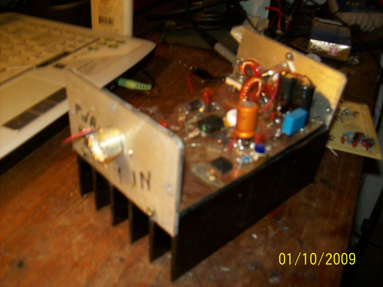

OK, Here's a picture of the world's smallest 80 watter
SV.. This thing looks like a dissaster zone from Gaza. To expect any reasonable results you do need to "clean up" your technique.. I won't go to lenghts - but just look in the very centre of your picture.. see the 520Ω? resistor there accross the RF transistor? If this is not a dry joint .. I'll shut up. You do have "blobbes" of solder and a lot of flux all over the place.. (btw- that resistor looks like it has been attacked with a chisel).
If there are to be any comparable results you'e looking for dear SV, every "project" must be "neat" to be consitant with your tests. This is even more so when in RF designs.
It is only suggestion of mine that you throw this "thing" into a bucket, poure a litre of methylated spiryt (and set it alight..:)) .. No!!!
No - joking:).. pour the metho in and let it seat the for 3 days. Then, as you're taking it away, brush off all the flux away (it should have resolved all but some by then).
Then with a good magnifying glass, take some crticism of yourself and "re-do" the joints that (surely), even to you do not look right..
[I do pride myself on the best soldering joints there are and I did fail my own tests under the microscope more times than I can even remember]
Microscope is not reqired but a good x 15to20 watchmakers glass will tell you more than I can say..
Only after rectifying these joints you do not like yourself, you will have the RF AMP "worthy" sharing your comperative experiences with.
Also, if you do want to improve your design.. buffer, isolate supplies.. as suggested in many posts earlier.
[Think of it also along these lines; if the AMP overloads the Driver, then the driver probably overloads the Mixer..]
Most of all - if your assembly technique is not up to standard - do not expect results even if you had used 100s of PICs..
xanadunow
Hey that's pretty funny Xan :) Now which one are you talking about? The 80 watt amp? Probably. That thing has been re-worked a few times. I used to have a T/R relay stuffed in that box as well. nI just snatched that out. But I am telling you, this sucker puts out the watts and it is clean clean clean. I mean nice! I got a TV set in this room that runs off an areal antenna. Just local broadcast, and it does not pick up the slightest interference on any channel. So right now, it is performance I'm after. Now when I get a chance, I will do exactly as you say. In fact I have some real nice Avvid heat sinks with fins that are about 4 inches stinking out from the base which is about 6 or 7 inches long and about 4 inches wide. I think I will build a push pull on it. Also I need to mount that LM317 on it too because that baby gets hot! It is basically suspended by wire because no matter what I put on it to cement it to a two watt resistor, expoxy or anything, it melts. It has even de-soldered itself before. When I first put it together I didn't have much on hand.

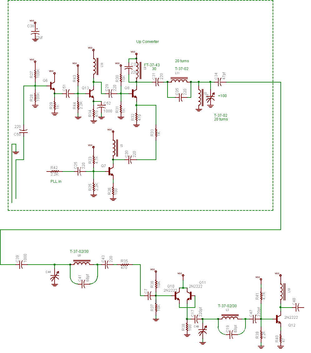

OK, thought I disappeared on ya, didn't you? Nope, just got busy, that's all. Here's what I did. I hooked up the 80 watter and it was putting out a gorgeous signal after some re-work then I CQed & CQed (call to any station) but got no calls back. Well, at 80 watts you can only imagine what my receiver sounds like listening to my own signal. Oh, oh did talk to one guy who said my frequency was "wondering". So I constructed a PLL for it. I am in a hurry to get most of the band, so I took a short cut until I have time to update the programming. So, since I am creating the reference frequency using the PIC timer, I figured I would supply the processor with an external crystal clock and make it a VXO so I could vary the reference. I think my frequency is allot more solid now and I can actually make sense of my signal using the receiver sitting right on my desk.
Well, when I changed my signal source to PLL in my up-converter, I had to go down the chain looking at amplifiers and filters to keep the signal drive for the 80 watter. I did make some changes and I got so tired yesterday I never tried a QSO.
Here's the changes in the up-converter. The two wire cable is some RG-174U from the modulator section. The up converter puts out about 1/8th watt and is sufficient to drive my 8 watt linear amp which drives the 80 watt.

Hi SV, I like following this thread.
You really are not a fan of decoupling Vcc locally.
Yes I decouple quite a bit, but what do you mean by local? You mean every stage? No I don't do every stage.
To answer Nigel, yes I do have a fetish for Darlingtons because if you are needing a buffer, why not get the extra current drive, after all the bottom line is power out, so....IXE
