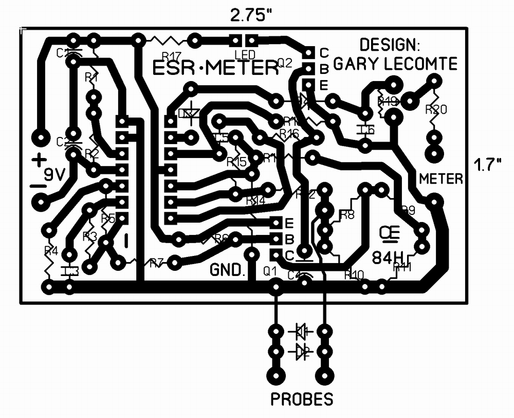

Based on the Circuit in Post #2, Here is a PCB I Designed up.
This is Not Tested Yet, But I believe the Circuit should be good.
NOTE: THIS PCB HAS ERRORS.
Hi Chemelec
Firstly, thank you for going to the trouble of producing this PCB .. .. ..
Unfortunately, at this moment in time I don't have the means to produce a custom PCB .. I tried etching once .. .. never, ever again .. I got into such a mess .. .. ... I have a small CNC machine planned and partly manufactured for the purpose, but I'm a way off completion . I have the x axis bed complete and I'm currently working on the gantry, but there's a lot of work to do yet.
Maybe some of the other members will be in a position to make use of your plan immediately .. but I will keep it in store to try out my machine in the future.
Thanks again
S
Slightly Revised.
I can Produce this PCB, But shipping costs to the UK are not very Cheap.
PCB and Shipping would be 10 Pounds.
But First I Need to Build it to see if it Actually Works.
And do a Comparison of results to My SENCORE Capacitor Analyzer
