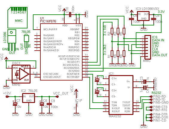

When accessing an SD Card in SPI mode should I pull up the unused contacts on the card?
I havent found a definitive answer to this one - I have seen circuits which demonstrate using pullups and some that don't bother.
What do you recommend?

YES. The used ones should be pulled up as well. It's in the documentation somewhere.
Hi Futz,
Long time no hear - hope your keeping well.
I am building an SPI\SD Card circuit from scratch, I am favouring the attached circuit which uses resistors as 3.3v level shifters.
How would I "Pull up" these?
Regards
Mark
I'm not much of an electronics expert, but I would guess you would make those voltage dividers pull up by making the high side resistor a bit weaker than the low side one?
But don't quote me on that. Now someone will give you a better answer and I'll learn something.
Chances are it'll work fine without pullups on the lines you're using, but I don't know for sure.
to pull them high i would put 3 resistors (4.7k) from the TOP of the divider to the to 5v.
Or just make sure those pins stay HIGH when not in USE.
I am not sure what that means, I don't see how those 3 resistors would allow give a high 3v when there is a 0volt output on the 5v line and then drop low when the 5 volts output is high.

Thanks Bill, not really sure I understand your "tristate" statement - perhaps I really should get my hands on a 74XX245 as most of the examples suggest (which has pullups on the 3v bus side which is confusing).
Just correct me if I am wrong but would the difference between a circuit which uses pullups and a circuit that does'nt mean that i should alter the CKE CKP appropiately (active high vs active low)?

The pins are driven from both the master and slave in 3 wire SPI mode.
Since your microcontroller is the master clock its SDO and SCK pins are 0-5V drivers and the SD cards SDO is driven not open collector.
The only real problem will be if your micro has Schmidt trigger inputs on SDI as 3.3V will probably be too low for that input.
A neat chip is the 74VC1T45 for level translation, or a 74HCT125 or a MOSFET may work.
Then it's going to need a boost on the SDI pin. The 74HCT125 is common and it works for SPI. The resistor bits are fine for the SDK, SDO and CE outputs from the PIC.

Mr Jammin,
just a 18f2550 on a breadboard using (or attempting to use) hardware SPI to an SDCard (powered by 3.3v) via resistors forming a potential divider to convert 5v outputs to 3v.
There are loads of resources and threads on this site which are really useful.
The problem I am having is at the reset stage of the SD card (the very beginning), the SPI module does report receiving data but it is either 0xC0 or 0xE0 when it should be 0x01.
I am trying to rule out whether the potential dividers are at fault or perhaps is should take the more robust approach and use level shifters (74x125, 74x245).
Thanks BIll, so the upshot is that my PD's may not be at fault but the MISO line could do with a lift?

Well you will need a level shifter when using the SPI in hardware for the SDI pin. 3.3V is just not high enough for the Schmitt inputs on a 5V PIC. I'd have to check the datasheet but I recall it's something like VCC-0.8 (4.2V) is a 1.
Use the Logic tool (TTL level won't really show Schmitt level triggers) to watch those SPI signals. See if they match up with what you're getting.
