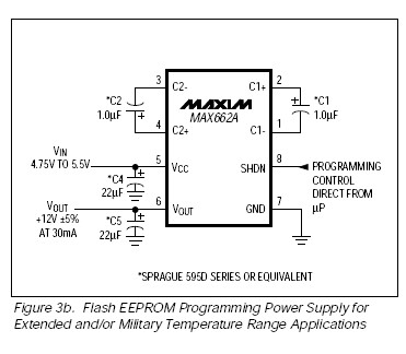

So the diagram should have a plus sign for the shown capacitors? I mean I need polarized capacitors?

See figure 3b in the PDF it has the plus signs back? Also they use 22uf caps there.
So I'm confused, can anyone list best correct capacitors for my project from these 2 sites:

C1 and C2 must be in the range of .22uF to 1uF as the datasheet indicates. That's a large range, making precision capacitors (±10% tolerance is fine) unnecessary. The datasheet gives the connection polarity for capacitors that are polarized; Cx+ for positive and Cx- for negative. Generally, capacitors lower than 1uF are not polarized, so then, the connection polarity is not relevent for those.

For C4 and C5, use the same capacitor you choose for C1 and C2, but increase the value to between 4.7uF and 10uF, inclusive.
In figure 3b, the capacitors are nonpolarized, 0.22uF, so they can't be connected backwards.

The caps in figure 3b are polarized see picture. So to clarify things up. I need 22uf or like you said 4.7uf and 10uf?
Tantalum or electrolytics is better for C4 C5?

If tantalum, use 4.7uF-10uF. If electrolytic type, use something greater than 10uF. Tantalum capacitors have lower leakage current and lower ESR than electrolytic. You can choose larger capacitance values for C4/C5 to reduce ripple even more, but you get diminishing returns at needless loss of space and increased cost. The polarity of the capacitors in Figure 3b is still correct (sorry, I was looking at 3a).
I do not know the effects of a small amounts of low frequency ripple in the LED current in your application. If ripple is a concern then you want to use a higher capacitance value for C5, rather than a lower value. You can increase the value to a hundred uF, or more, and the circuit will work.
