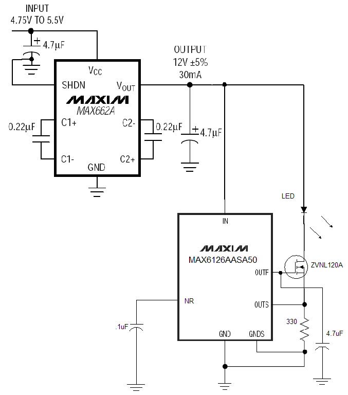

I'm also waiting for someone to propose a schematic for MAX6126 chip (what tranzistor and rezistor I need for 8mA) as it has got "Low 200mV (max) Dropout Voltage" versus 1V for LM234/334 chip.
The tranzistor and rezistor for MAX chip will eat some voltage too so perhaps 200mV is not real here and could be higher.
The LM134/234/334 is nice, but what about accuracy and thermal stability? I did not fully understand that part of PDF. Remember I nedd to reach stability at the second number after the decimal point or better.
Did you mean this schematic? The datasheet contains many packages and type of this chip which one would I need?
It shows one transistor and one resistor connected. Could you help me choose these components too? I have no knowledge how to do it myself.
I apologize if my question seems stupid or something and the answer seem obvious.
My simulator microcap9 does not have this part so I can't check anything.
Yes, that's the schematic, but I realize now that it won't work with only a 5 volt supply. Even if you use the device having a 2 volt output, you need a supply voltage of at least 6 volts, preferably greater. Your LED has a 3.9 volt forward voltage drop. (2+3.9=5.9v)
This will get past the 5V problem. Now's it's a matter of finding the right MOSFET. Next time.

Thanks for the schematic. I really appreciate your work. It would be nice if it would work from 5V as using USB is convenient (every laptop has one).
What is bias?
Perhaps using MAX662A (that makes 12V) and (LM234/334) would work if MAX6126 has a problem with bias?
But if it's not possible then, I guess I have to buy 12V wall adapter for it but I want to this only as a last resort.
Smilem, I came up with the parts on the attached. Mind you, have I have not used any of these particular Maxim parts in my experience. Based on the datasheets, I think it is a workable solution.

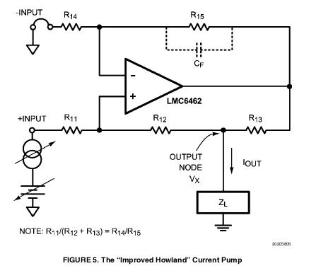

this is a precision current source. the accuracy is dependent on the tolerances of the resistors and your voltage reference. the feedback loop excercises extremely tight control of the current by sensing the voltage across the load. R13 is the scaling resistor. the National Semiconductor App Note makes interesting reading and is available here:
i've actually built a working model of this current source, and it's an excellent circuit. i built a high power version of it because i needed a 1Arms AC current source (i replaced the DC voltage reference with an oscillator) for an accurate impedance meter. if you're using it to control an LED, any good op amp will do.

I cant' get MAX6126AASA50 :( , instead I can get MAX6126BASA50 (±0.06%; 5ppm/°C; 5.2 ~ 12.6V; 10mA; 380µA) or ADR425BRZ (±0.04%; 3ppm/°C; 7 ~ 18V; 10mA; 500µA;). Do you think it will be ok to use MAX6126BASA50?
Thanks for the circuit.
Yes, that variant is fine. You are more interested in stability over time and temperature than the actual current level at turn-on. The initial current value is adjusted by tweaking the 330 ohm resistor, anyway, in this circuit.

Do I need to put 662A and 6126 IC so that it has thermal contact with some sort heat spreader like glue it like "dead bug" to a small piece of copper PCB using thermal glue then use it as normal component?
Also I need MAX662ACPA or MAX662ACPA+ (this is 3 times more expensive for some reason), PDF is the same.
Should I choose some high accuracy capacitors too, temperature stable? Unfortunately I don't know how to distinguish them, or it does not matter?
The thermal stability of the part is better than the 330 resistor and the part will hardly self-heat much. I use electronics grade, silicon RTV (not the vinegar smelling type), which happens to have good thermal conductivity. The capacitors don't need to be precision values, just good quality ceramic or tantalum.
I don't know the what the + means at the end of the 662 part number. The one without the plus will work fine.
High-K ceramics are temperature unstable (X7R, Y5V, etc). C0G/NP0 type ceramics should be very temperature stable.
As for the tantalums, I have no idea. I do know they are preferred in sub-zero conditions due to having a solid electrolyte vs. your standard aluminum electrolytic.
The temperature stability of the capacitors is not an issue with regards to the stability of the current through the LED in the circuit. The capacitors are used only to reduce ripple current, provide charge storage, reduce noise, or filter spikes. Any temperature instability in the capacitor at the gate of the FET is countered by the error amplifier inside MAX precision source, if that instability has any effect at all. Any temperature instability in the other caps is irrelevant.
Actually, there are ceramic caps with very good temperature stability. They are known as NP0 types.
If they are just power supply filter caps like ccurtis said, then you don't need C0G/NP0. X7R and X5R will be fine in that case. So will aluminum electrolytics.
