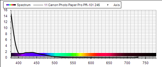

I will use this as my light source for fluorescence tests of various substances. The LED I use is an UV type. PDF is here with all specifications: https://www.elfa.se/pdf/75/07500366.pdf
“Are you just trying to distinguish mixtures based on spectral data? You won't be able to change the wavelength of the led”
Yes. I will plot 2D X, Y line graph. See attachment. Then compare the results. If the current is not stable then LED light source will fluctuate and I will not be able to compare samples as the data will be not accurate.
I know I will not be able to change wavelength. This UV light source will be used only for fluorescence tests. For other tests the spectrophotometer has it’s own light source, but it’s UV-cut so I’m trying to find a solution.

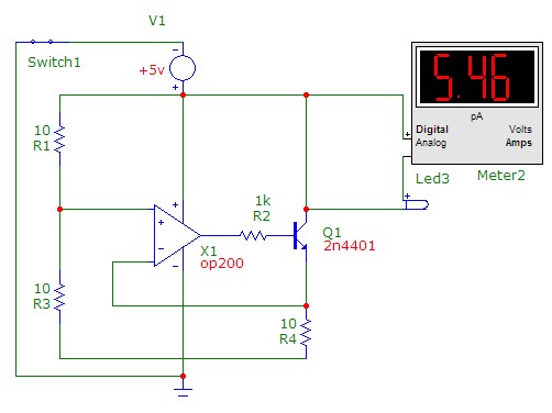

The picture is a common current source.
I would short out the load resistor.
Open the collector connection and add the LED from +5V to Collector.
Maybe open up the base and add a 1k resistor.
Sense resistor...about 70 ohms.
Replace zener with resistor to make a 10:1 devider to get 0.5 volts.
Use low voltage op-amp, common mode input range must include (-) supply.
Your LED needs about 4 volts so the sense resistor must use up less than 0.5 volts.
Is this circuit correct?
What resistors do I need for R1, R3, R4?

As your diode needs 3.9V I'd try to scrap the 5V requirement, you're always going to be pushing muck uphill with a sharp stick to get precision current sensing and control within the spare 1.1V, given you want something like 50ppm/C stability. I'd get some voltage to play with then you should have multiple options, using a precision op-amp and precision voltage reference for example should make it pretty easy to make your current source.
Since I transfer all data from specrophotometer to PC I wanted to use USB to power it and my external LED light source too :confused: And on a laptop there is not 12V plug like on desktop.
