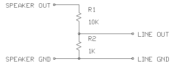

I have a Casio electronic piano that does not have Line Out connection. I used the headphone connection for a while but it is noisy and have a low frequency hum which is not acceptable. I peruse the web and found the attach circuit. I used a DI Box , to convert the headphone signal to line signal, but decided I want a permanent solution. Since the keyboard have two speakers I disconnect one , built the circuit and attach the speaker output to it, It sounds good and the the hum noise is not present.
The questions is do I have to add a resistor (6 ohms) to compensate for the load (speaker)? The speaker is rated 7w , 6 ohms.

No, the entire load resistor thing dates back 75 odd years to valve amplifiers, which can destroy the output transformer or output valve if used without a load - 'modern' (50-60 years old and newer) semiconductor amplifiers have no such issues, and are even happier without the load as they will run cooler.
As above, the amplifier will work fine without the low impedance load. but - you do not have to disconnect the speaker for the output being used. You can connect your line out circuit across the speaker. The amp circuit will not care.

Another suggestion, if it is a stereo keyboard rather than mono (the two speakers come from different points in the electronics):
If one side of each speaker is connected to the internal amp ground, use a resistor from the driven side of each speaker to combine the two channels - that way you do not lose anything if there are differences between channels with some sounds.
eg. In your circuit, add another 10K from the other speaker driven terminal to the line out junction.
Thanks a LOT !!! to Nigel , AnalogKid and rjenkinsgb . I will implement the circuit right away. It have two speakers but I don't really think they make a difference (stereo) . If they do, I can considered rjenkinsgb suggestion.
