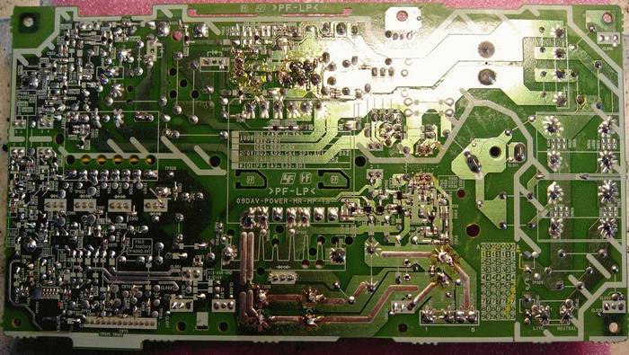

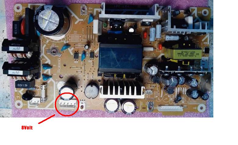

I have this sony receiver and it doesn't power on at all...
Power Supply model: 09DAV-POWER-MR-MP-13
I started looking the power supply and fuse on it are ok.
At rectifier output i measure 32V dc
The red circle the output is 8V and on pcb it reads 32-0 32-0
So i suppose this is the problem but don't know how to find the defective part
Every part on pcb looks ok...
Any suggestions will be appreciated

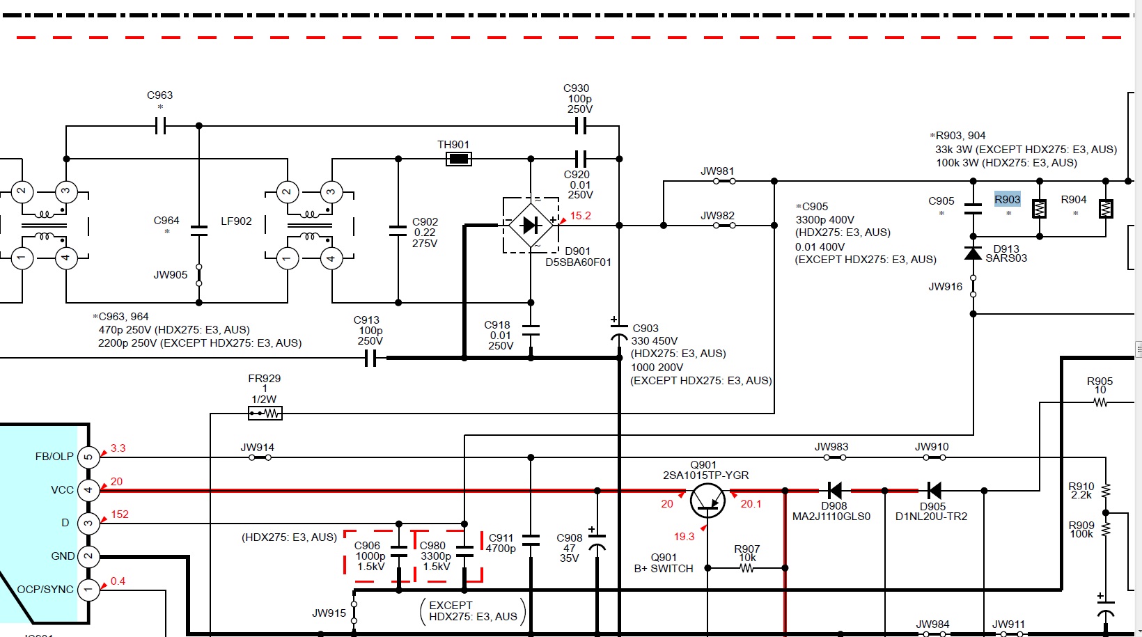

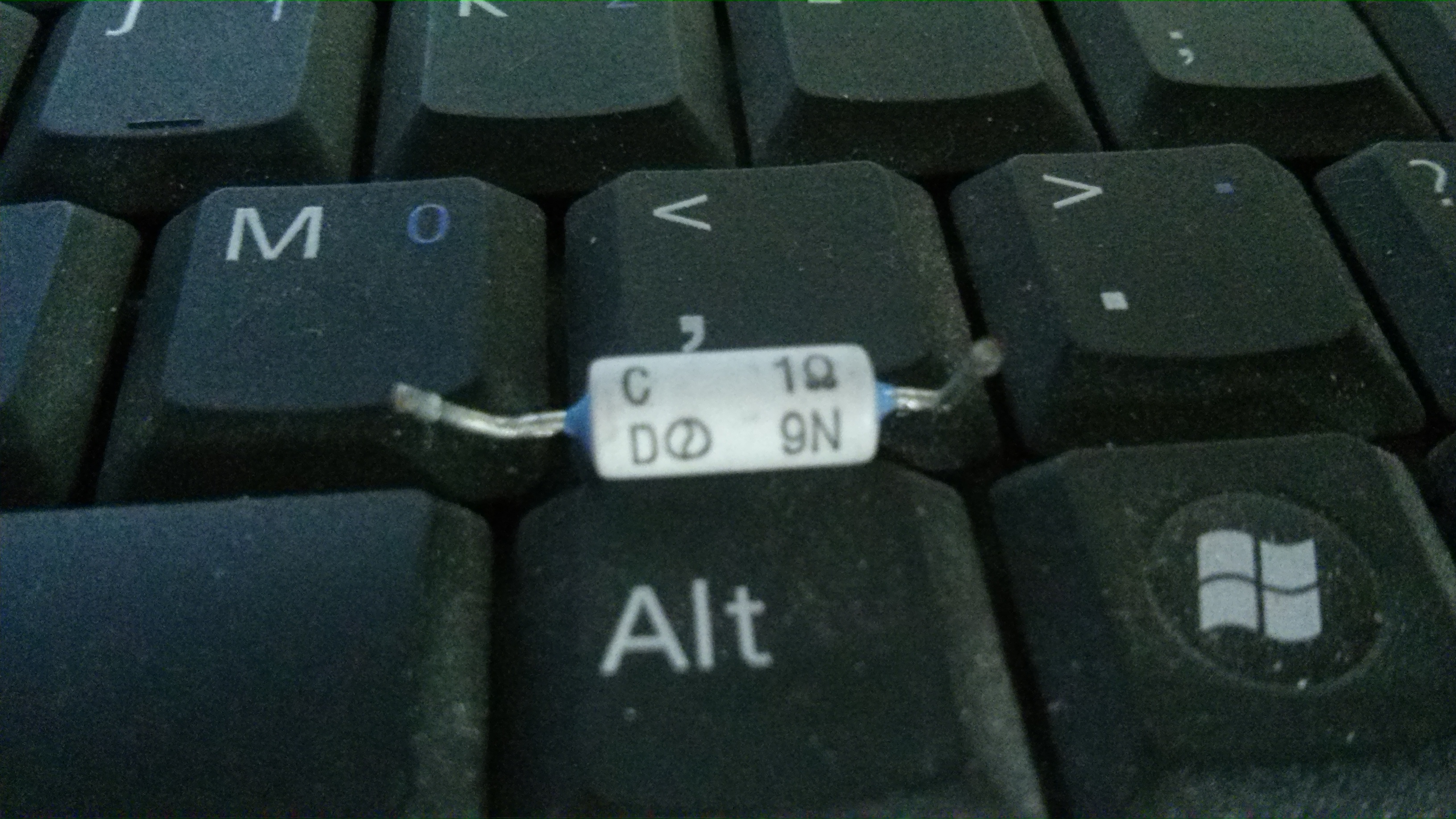

Found out today that FR929 is open.
Can i replace it with simple 1 ohm 1 watt resistor?
That would make me suspect IC921 - but you could certainly try a simple 1 ohm resistor (leave it stuck up on long wires) - the original is a special safety type, but while working on it a normal one will be fine (it will get destroyed in a much more 'exciting' way :D).

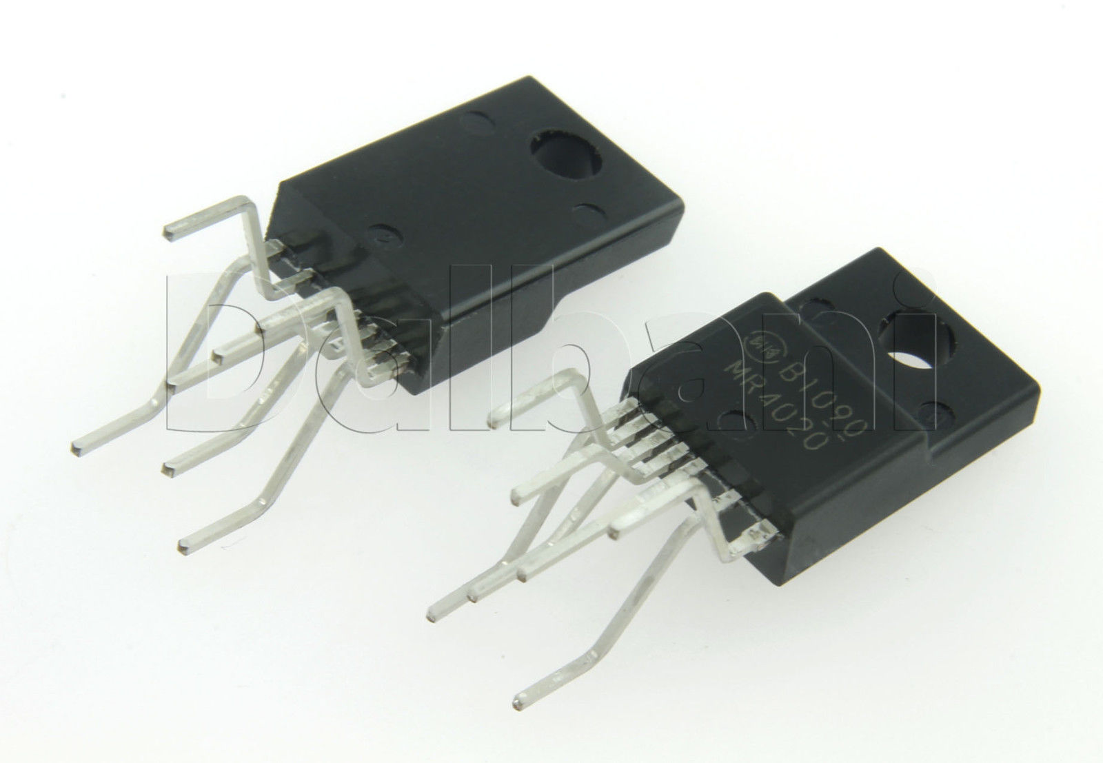

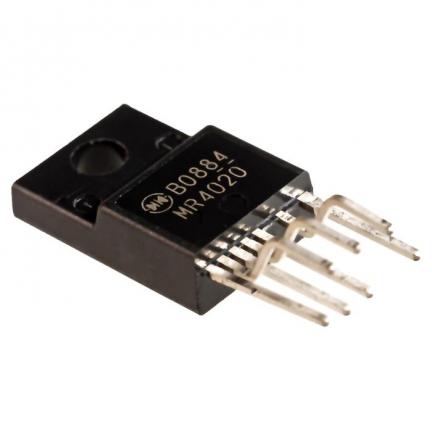

So this IC is dead i suppose and hard to find for replacment ?
In a store i looked i found only the one in first picture below(the burned out is second pic with long legs)
Will this work for replacement if i use wires to connect all legs as the old one ?

I checked the resistors suggested in another forum and all were OK.
However there was only about 200 mV on the emitter of Q922 and even less on VCC of IC921.
The 320 V rail was OK and I noticed that the heatsink of IC921 was pretty warm.
I measured the resistance from VCC to GND of IC921: only about 7 ohms so obviously something was very wrong in the vicinity.
