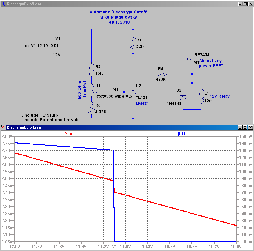

Look at this. Uses my favorite part, the LM431 You might be able to eliminate the relay. The PFET can switch several amps...
thanks so much for your interest & help, I dont know much by looking at components.. that circuit can do as asked at the top.. I.E. 1.2.3.!!!

Since you mentioned High & Low limits I suggested using a Window Comparator where for example you could have a slave small relay energized between 11.2 V (Low Limit) and 13.4 V (High Limit). Anytime the limits, high or low were exceeded the system would drop out. That part is easily done with several components. Additionally tossing in a delay is not a problem, meaning if the system goes out of limits for several seconds it won't drop out the relay. You could likely configure a 555 timer in there for a delay and if limits return to in limits during delay nothing will happen. You would need a version for a 12 Volt system and a 24 Volt system.
The second option I proposed would be to use a PIC chip. Using a simple micro controller would be easy but would require programming the PIC. Overall likely fewer parts but programming would initially be needed.
The other circuit proposed by MikeMl would also work but I think it would only shut down for a low voltage condition so you may need another redundant circuit for your over voltage if that is important. I really like how he did that but he can better comment on his design.

You don't need a window. Use the OP amp as a Voltage Level Detector. What you do in use I believe the positive input to set a reference voltage. You can make it adjustable by using a variable resistor (3 prong type). Tie one side to the positive supply voltage and the other side to ground. Then connect the wiper to the positive input of the OP Amp. Now you can adjust the level. Then your battery will go into the negative input of the OP Amp. When the voltage drops below the reference (variable resistor) the output will switch.
Yes, a simple comparator will work just fine but... the original post calls out a high and low level. He wants to work within those levels or a range of "Low & High must be Variable.. (set Low at 11.2v / High at 13.4v)". He has an under volt and over volt condition. What is suggested above is a simple non inverting comparator which will work just fine when the battery voltage drops below a threshold determined by the pot, however, it won't respond to an overcharge (over voltage) condition. That is why I suggested a window comparator and not using a non inverting input comparator.
Ron
No problem. :) I tend to do the same thing.
Ron
I'm curious though. Why does he want the window? Maybe he wants to use it with a charger too.
That would be my only guess. Maybe to be used with a charging system and he is concerned about over voltage? I guess only he can answer that directly. It would be simpler with just a shutdown of the load on under voltage. I also thought about latching a shutdown because once the load is removed the battery voltage can creep up above the limit and the thing can engage the load again.
