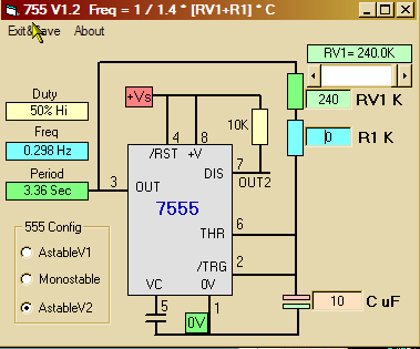

If you just want a 50% duty cycle from a 555 timer, its possible to use a circuit configuration as shown in this image.
Eric:
How much temperature stability will be lost and how much power supply voltage stability will be lost using that method?

Hi Eric. I did see that equation, essentially R2 is put to zero ohms and I should get a 50% duty cycle. But I tested it and it wouldn't work, I don't know why so I moved on. I will try it again, maybe I made a simple error.
Hi MrAl. The calculation is just too complicated, I can test it quicker than solving the equation. I will set p=1 on the proto board and then alter q till I can home in on it.
Hi, I did but still no luck. I'm wondering if there is a chip difference. I have a NE555, whereas i think the later chip is LM555. I'm fairly sure I read that 555's shouldn't have a duty cycle less than 55%, I forget in which context exactly though. I think trial and error may have to be the case, and I'll order some LM555's when I next need some kit.

A 50% duty cycle is referenced in the LM555 datasheet with a schematic but not in the NE555. I will make up the exact circuit in the LM555 datasheet with my NE555. If it doesn't work I will know what the problem is.

I decided I can live with a duty cycle that isn't exactly 50%. I can't get the schematic you posted working nor the one referenced in the LM555 datasheet, I'm not sure why. Starting down another track is something I will have to leave for another time, thanks for the offer though! I will shortly begin putting this on a stripboard, I will use leads for R1, R2 and C so I can change values later, prior to final build. The only question I'd have is how does output voltage compare to supply voltage? I'm thinking it is about 2/3 so If I want 2V I should supply 3.
It is early here in the UK! :)
The output level from the 555 depends to some extent on the load its driving, I would think that the 1V overhead would be a good idea.
Where in the UK.??
BTW: I did run some LTspice tests with varying temperatures and supplies, I found VERY little change in the frequency.
I would have thought this configuration, ie: output linked back thru a resistor is no more susceptible to Δt and Δv changes than the 'standard' astable configuration.

Hi Eric,
I dont think a spice test will show the difference anyway. A real life test may or may not show the difference depending on the actual specific ic chip, but it probably will.
Check out the data sheet variation over temperature for the output transistors and compare to the 'discharge' transistor variation. When using the discharge transistor the circuit is more stable. For another thing, the supply voltage can not change relative to the internal divider as it can with the output.
The 555 was made to be pretty darn stable when used correctly, but then again if the application does not need that level of stability it's all academic anyway :)
One thing is for sure though, the output resistor drive is a lot easier to adjust and maintain a 50 percent duty cycle at the same time.
