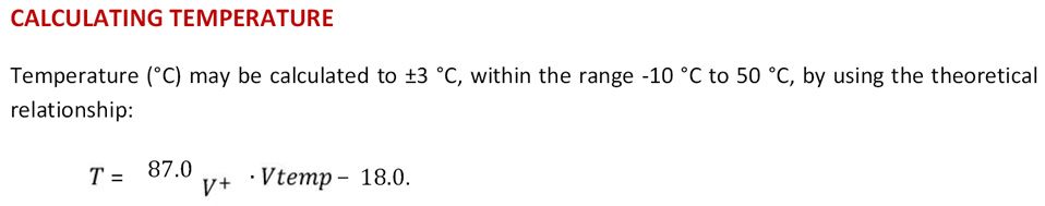

I think I mentioned somewhere that I am working with a CO sensor - here is the datasheet.
A signal, Vgas is used to derive ppm CO. The derivation is improved by some temperature compensation.
There is another signal, Vtem, that is described in the datasheet as - Voltage Output. Vtemp is proportional to temperature.
The relationship, however, is not given in the datasheet (at least nowhere that I can see and I have looked).
Looking further, specifically here, I found the relationship. The relevant section appears below.
I do not understand that formula and am under the impression that something is missing or that something should be inferred/assumed that I am not getting.

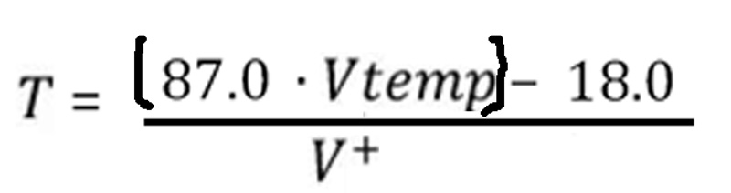

This is how I changed it for use in the first post.
The resulting function is about in the +/- 3C range as advertised - as compared to the ds18b20 and within a small range that I sampled. I need to write the company and ask them.

But you're not alone, it's rare to see any such formulas in datasheets that do make any sense, but in this case it's obviuously seriously misprinted, and the proof reader should be taken out and shot. Perhaps this problem is normal?, and why it's often so confusing.

From: Ed Stetter <efs@spec-sensors.com>
Sent: Friday, November 22, 2019 9:25 PM
/- snipola -/
Sorry for the trouble, you did indeed find an error.
It looks like there was an error in the conversion of that manual from .docx to .pdf. As a result, a division sign in the formula is not shown.
The correct formula is:
Tcalc = (87.0 / V+) * Vtemp - 18.0
We will correct the documents but hopefully this helps. Sorry again for the mistake.

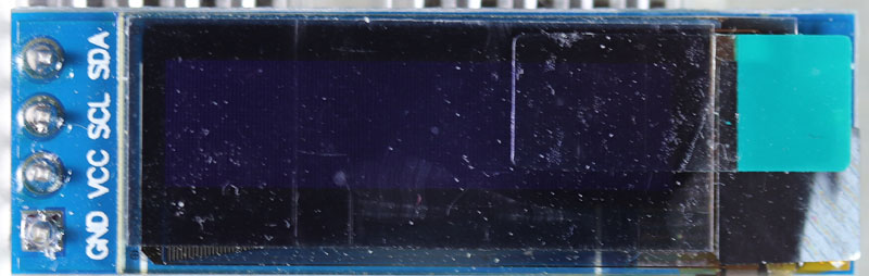

At first, I thought that I would use one of these 0.91 inch, 128 x 32 mono OLEDs that use an SSD1306 controller. They are cheap and I have used them before. You can get two lines of text/numbers, but it is tiny.

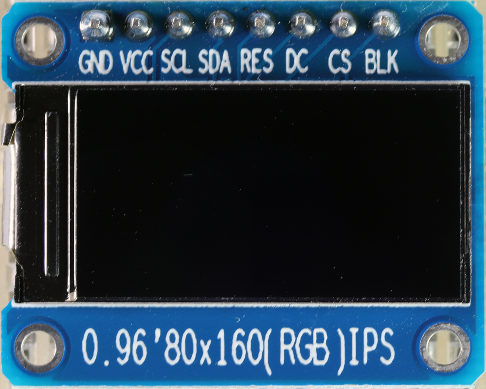

Instead, I went with one of these.
It was just a few bucks....it uses an ST7335S controller and (as though I just can't learn my lesson), they are poorly documented and you can expect to spend more than a few hours getting a driver up and running. But, they are a nice little display for my purpose.
I had given up using a promini or other slow Arduino clone and went with a Teensy LC - a decent board. Their "teensyduino" interface software (lets you use the Arduino IDE) comes with an optimized version of the Adafruit 7735 library which also uses the familiar Adafruit GFX library.
Of course, there is no initialization options for this display...you are pretty much on your own for that. I decided to modify the ST7735_t3.cpp driver file (yes, of course I saved a copy of the original). To make a long story short, I had to figure out and change CASET and RASET and change some starting x/y values - and I did this working off of the existing INITR_MINI160x80 options because that initialization code is closest for what I needed (but it is not that close).
Then, I had to uses options for inversion and rotation. Oh yeah, and one more thing, I had to convert the 5-6-5 RGB colors to BGR, e.g.
 #define ST7735I_ORANGE     0x041f // 0000010000011111 was 0xFC00
On this point, I would say to anybody who is listening - if what I have written makes no sense, then just buy a board that is supported by the driver. Yes, it is more rewarding to buy a dirt cheap display and get it to work, but.....I spent a lot of time on it AND, the right way would have been to write a custom initialization just for this board. Frankly, I just didn't want to do that, although I probably could. So, the display that I used cost US$3.45 including shipping and I bought two of them. The comparable Adafruit board is US$14.95 not including shipping. Yes, there is a difference, but how much is your time worth?

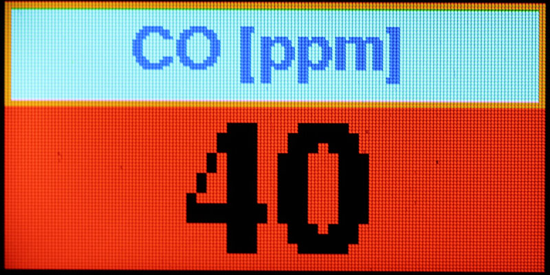

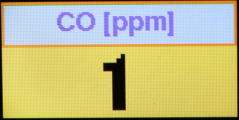

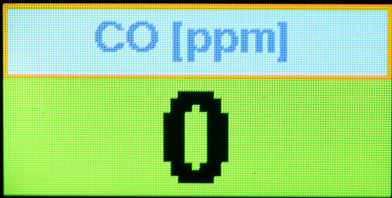

In any event, the driver is working as far as for what I need so I worked on some displays:
and when we are above the lowest threshold, we have a "yellow" alert (up to 1.5 ppm right now)...
...and at 2 ppm on up we have...
In testing, I am happy with the SPI display speed with the Teensy LC.
The display only uses 20 mA and the sensor is very low power. Feeding the Teensy 5V gives me a regulated 3.3V pin out at 100 mA, so I am good even after adding an alarm.
So, onward...need an alarm...move it of the enclosure...test it in real life...enclosure (ugh).
