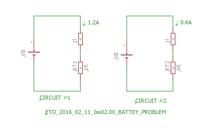

As a general point of interest, assuming that the two schematics above correctly represent the two configurations that you describe, am I right is saying that practical solutions for VB and ri (battery internal resistance) are only possible if the current in CIRCUIT #1 is greater than the current in CIRCUIT #2 (RT represents the resulting resistance of the parallel and serial configurations of the two 2 Ohm resistors respectively)?

No angst Ratch. I was just interested to establish what values for I1 and I2 you could specify and still solve for practical values of ri. In my schematic, of post 31, call the current of CIRCUIT #1, I1 and the current of CIRCUIT #2, I2.
Using simultaneous equations and all that you end up with ri = ( [I1*1]-[I2*4])/ (I2-I1).
From this equation you can see that:
(1) if I1 = I2 the denominator will be zero and the numerator will be -3, so ri will be minus infinity.
(2) if I1 is less than I2 the denominator will be positive and the numerator will be negative so ri will be negative.
Thus I1 must be more than I2 for the solution to produce a real value for re.
That is all.
spec

Thus I1 must be more than I2 for the solution to produce a (real) positive value for re.
That is all.
spec
If you are willing to accept negative resistance, then your currents can be anything you want. Otherwise, you cannot expect to have more current after increasing the resistance.
Ratch
Hi Spec,
Your equation gives the correct value for the internal resistance of the cell .
ri = ( [I1*1]-[I2*4])/ (I2-I1). gives the correct answer.
= (1.2 * 1)- (0.4 *4)/(0.4-1.2)
= 1.2-1.6/-0.8
= -0.4/-0.8
= 0.5
