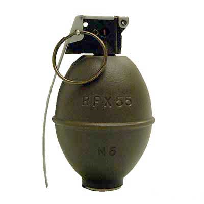

What could be done is use a device as pictured in the attached image. Place the device in a tubular can and remove the pin, make sure the spoon has a tight fit but loose enough for easy slide out. Tie a small piece of wire to the device and the solar panel. Make sure the trip wire is hidden as well as the device.
This method may be a little rough on the solar panel but I can absolutely guarantee response time will not be a factor and you will likely never have the same thief twice. When the device exits the secure tube the thief has between 3 and 5 seconds to think about a course of action. :)
OK, seriously, I like the reed switch or PIR sensor approaches but had to suggest my way.

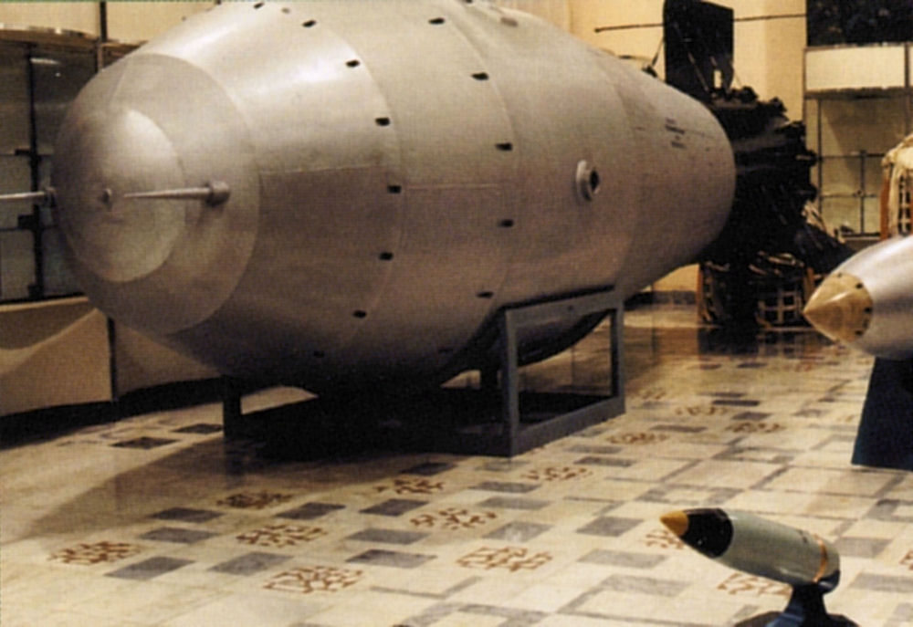

hi Ron,
I like the idea but its a little under powered, something like this would solve most problems.:)
