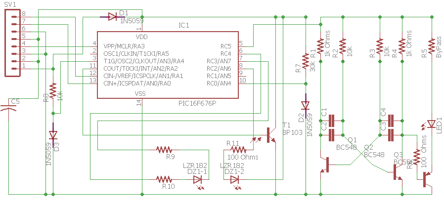

Here is my circuit, but I hope it will hold up off the bench and charging itself!
Any advise to make it better?
some facts to understand my schematic better:
SV1:
pin 1 is 5v solar input, 1/2 watt i think( it pushed out 10mA on a test today, but it was cloudy)...
pin2 = 2 or 3xAA batteries in series
LZR182:
substitute to make holes for common anode RGB LED (i realize polarity is wrong, will fix in hardwire)
T1:
TSOP IR receiver equivalent
LED1:
IR LED, driven at 40khz
SV1:
LZR182:
T1:
LED1:
