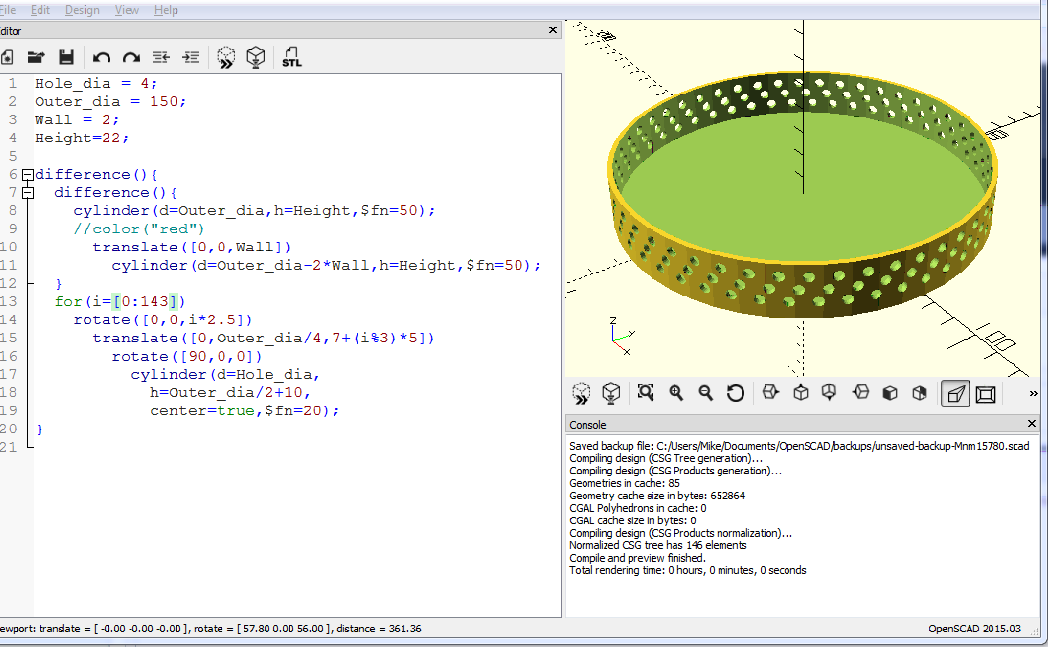

I recently acquired a Kossel type printer and wondered what people use to create objects. I started of using the free online Tinkercad from Autodesk but quickly outgrew that.
I've now started to play with OpenSCad (Open Source CAD) which uses a programming language to generate shapes.
A project I'm currently playing with needs 144 interrupts per revolution and so I am using three lines of holes to generate 3 separate interrupts. The code to generate this object is in the attached image.
It seems to be a very powerful and flexible program.
