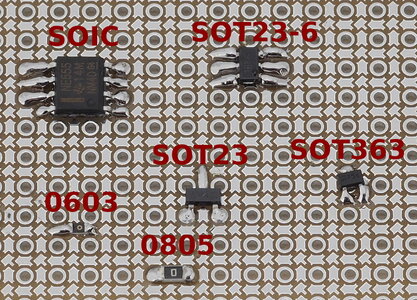

I was looking into different methods for making prototypes with surface-mount components and I stumbled upon this prototyping board design (see attached image). Here's a link to the github page of the person who designed the board in the attached image: https://github.com/electroniceel/protoboard.
I was wondering whether anyone here has any experience with these boards or something similar. I usually do point-to-point prototypes or solder components to a ground plane (copper clad board) but neither of these techniques work very well with surface mount components although I imagine it would not be impossible to use a copper clad board for larger SMT packages (1206, SOT-23, etc.).

I was aware of the availability of breakout boards but was looking for a prototyping method directly compatible with surface mount components. The board I've linked to should in theory allow one to use both surface mount components and through-hole components on the same board although I've never used one so I'm unsure of the downsides of using such a board. If no-one here has tried the boards I've linked or something similar I'll probably still get some to try and report back because they would be really useful if they work as intended and eliminate the need for breakouts for 1.27mm pitch ICs and 1206s.
I'm a bit averse to using breadboards generally unless I know I'll be replacing components frequently because I get the issue of dodgy connections sometimes unless I really take my time when constructing the circuit. Soldering circuits together makes the likelihood of dodgy connections far smaller which is important when you're scratching your head trying to figure out why your circuit's not working. That's just my experience though It may be a skill issue I don't know.
As a sidenote 1206s and SOT-23 transistors do work with standard 2.54mm pitch matrix boards but SOIC chips don't.

The pads are not interconnected at all, but there is a ground plane on the bottom layer. The outer circular pad connects to ground and the inner circular pad is just the other side of the plated hole on top. To connect a pad to the ground plane, you can just solder the inner ring to the outer ring on the bottom layer.
I like interconnections like in the typical solderless breadboards.
The board I linked is probably not a very good solution for those who prefer a breadboard-style prototyping board. I prefer matrix boards becasue they allow for more freedom at the expense of having to add more jumpers. I think your board design would can be improved if make the middle area of the board look like the board I posted whilst keeping the rest of the board identical. That way you have compatibility with SOIC packages and SOT-23 transistors while still preserving the breadboard-style interconnections on the rest of the board.
