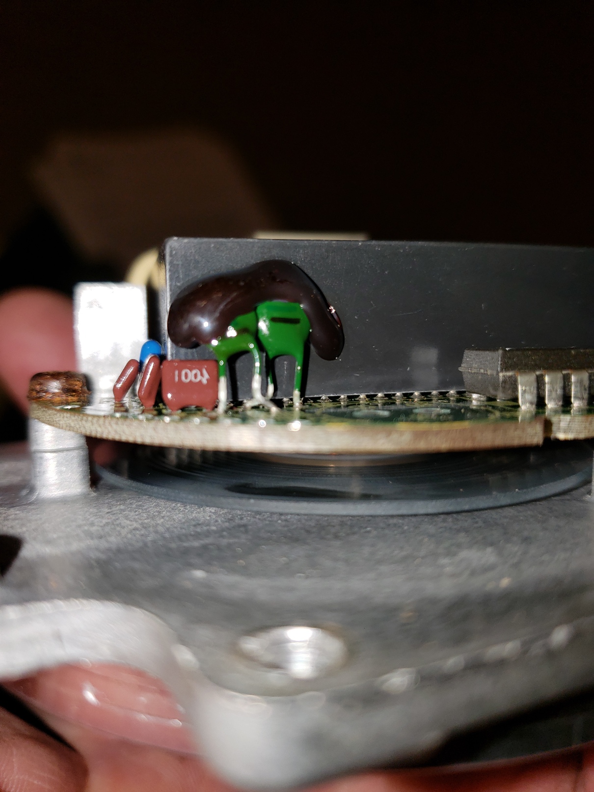

Hoping someone around here has experience in this? We are working on about a 2000 line encoder on a CNC machine that is giving us fits. i confirmed the wiring and power to it is just fine. So I removed it, gave it a little air clean and tested it and was able to fire the machine without errors and was able to jog it a little bit before it errored again. For this reason and my visual inspection, I believe the glass disc just needs cleaned. However, i probably only have about .100" in each side of the disc to get in there with something. Not sure if just alcohol will work? Concerned about streaks.
I won't be able to remove the glass disc without a complete teardown and risk because a bearing is somehow attached and all pressed together. hard to explain.
What I believe likely happened is machine was powered down for a while subject to some colder temps and condensation occurred, which did not damage the encoder, but over time has left a haze on the glass that is very obvious. I think it just spins to a bad spot and cannot see through the fog so throws an alarm.
Willing to order special materials for this repair but rather get some stuff locally and get it back together so it's protected.

Well, we are going to give it a test. Got it under the microscope and you could see a layer of particles over the entire disk. I used medical gauze and isopropyl. Under the micro, you can certainly see imperfections in the glass and appears made that way. There is just no way to clean the reader head without full disassembly so I will try this first I guess. There are multiple bands of segments on the glass to offer redundancy I would assume.
6 years I worked on encoders and kept all the factory machines running. Sometimes encoders can give you crazy problems and its not really the encoder. If encoder is belt drive sometimes belts stretch or wear enough to cause trouble. Machines usually have a ZERO starting point where you need to set the machine manually. Move your machine to the starting point which will be ZERO for the encoder. Adjust encoder to zero tighten belt and make sure encoder is still on zero, then see if the machine will run. Replace old belt with new belt test machine again. If encoder has no belt drive check the coupling. Check for bolts that are no longer tight. Check encoder cable. Swap cables if you have a spare. Swap encoders if you have a spare. Encoders are usually sealed up tight so nothing can get on the glass. I see you already tried blowing air on your encoder I hope you used canned air not air from air compressor hose. You can't use a Q-tip it might leave cotton pieces on the glass. What ever you clean glass with it can not leave residue on the glass. I always used 100% methyl alcohol in 1 quart can. Get a small diameter soda straw put it in the alcohol about 1" deep hold your finger on top end of straw so air is trapped then remove straw from can alcohol will not run out. Release alcohol onto the glass disc to wash it and let alcohol run off the side of glass disc. It is also possible the reader has a problem and glass disc is not the real problem. Make sure all alcohol inside encoder body evaporates before you put it back together. Call the factory service department ask for help they will talk you through the trouble shooting process.
First test was a fail. It is better but still will alarm after a little motion. This is not a belt drive. Every encoder is direct coupled with a plastic slotted key to the servo shaft. To complicate further, machine has factory installed upgrade linear encoders for true motion feedback so the servo encoders are only used to provide motor performance feedback.
I am unclear as to which part of the optics may now be of issue. I doubt I did a flawless job cleaning the glass but I have also seen people in the field clean these with MUCH less care than I used. I cannot tell which side is the light source and which is the "receiver" side of the device and which would give more issue or area of concern? The main PCB sits above the glass disc, then there is a small 4pin ribbon that connects to a flat component that runs extremely close to the disc. I know two of the 4 pins are identified as "Vss" and "Vcc".
It will be impossible to clean that device without full disassembly and that presents a challenge in that the disc seems to be glued to a shaft and that shaft goes through the housing and has the drive lug mounted to it. I know it will come apart but I need to get on the level of how it gets done.

On the rotary encoder, the head that is just below the glass disc, that rides very close to the disc, is screwed in place and glued, and I believe is aligned. The PCB, however, just attaches to the housing with 4 screws and virtually impossible, IMO, to precision align it. for that reason whichever component requires less precision would be on the PCB. I am regretting not getting a picture!!! lol
From my limited understanding, so far is the bottom device is the LED light source and a Moire grating and would need to be rather close to the glass wheel for optimal precision? The device affixed on the PCB above the glass wheel is the photo detector or "read head" if you will? So are both just as critical for cleaning? Would sure seem like it! Is isopropyl still a good choice for this cleaning, assuming I can get it apart?

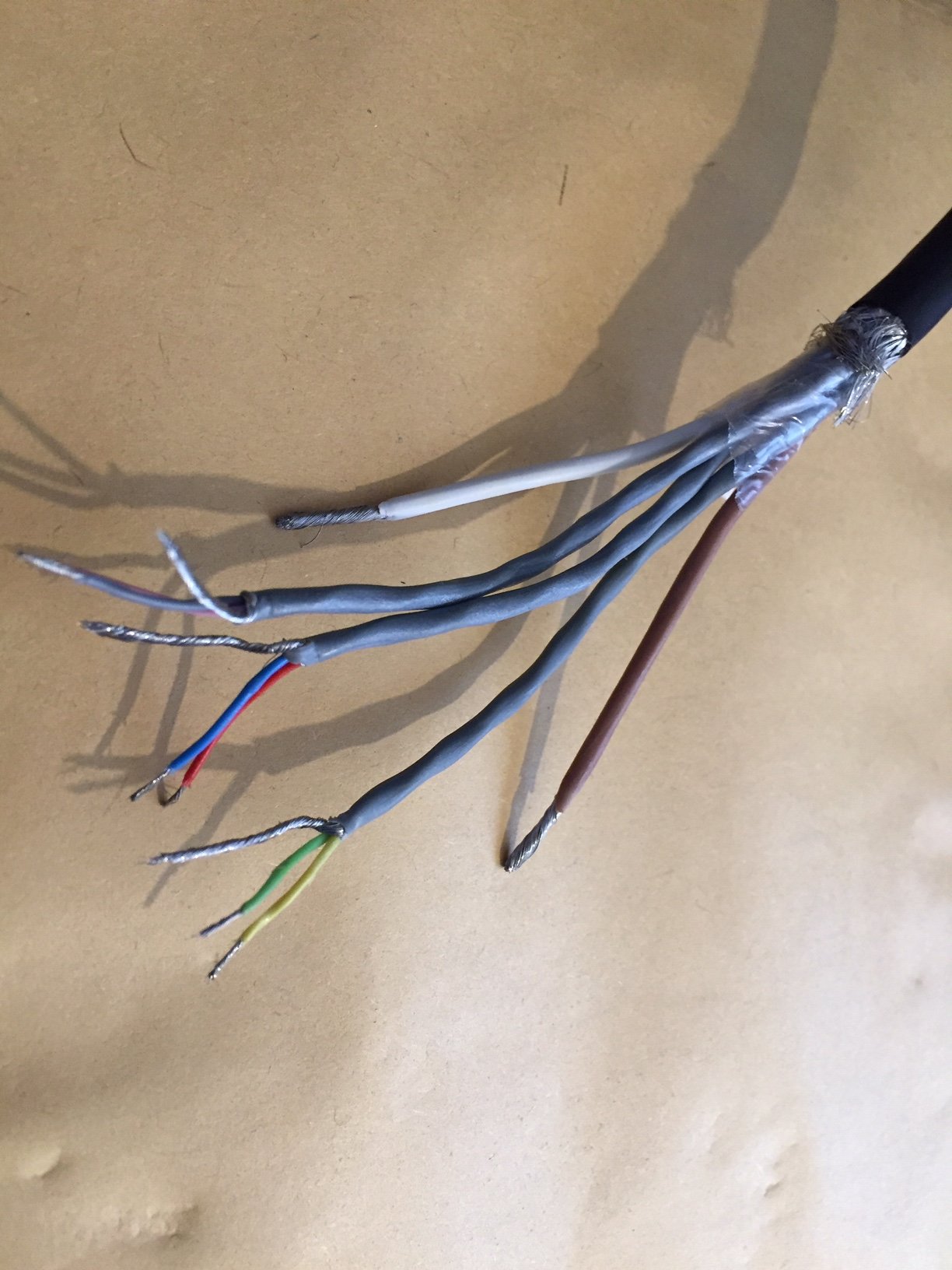

If it's a purpose made encoder cable the power cores are usually quite a bit heavier than the signal cores, sometimes massively so - so you may not get consistent readings across different connector pins.
Some are also double screened, with the overall outer screen to the machine metalwork & connector bodies, and an inner screen on the signal wires connecting through only to a pin on the CNC connector.
See the photo for an example - an offcut of Heidenhain cable for the 9 pin analog type encoders; the OD of the power cores is around the same as the jacket OD of each of the screened twisted signal pairs.
Any dirt inside the encoder is a worry - they are supposed to be completely sealed & that points to a problem elsewhere, such as the cable, gland or connectors being messed up.

The pic is the only one I have at the moment and does not show the read head arrangement. I was just getting a pic of the stuff on the disk. I did NOT touch that glass. I am not sure why there is a clean spot but once I saw that, I knew it needed cleaned for sure.
