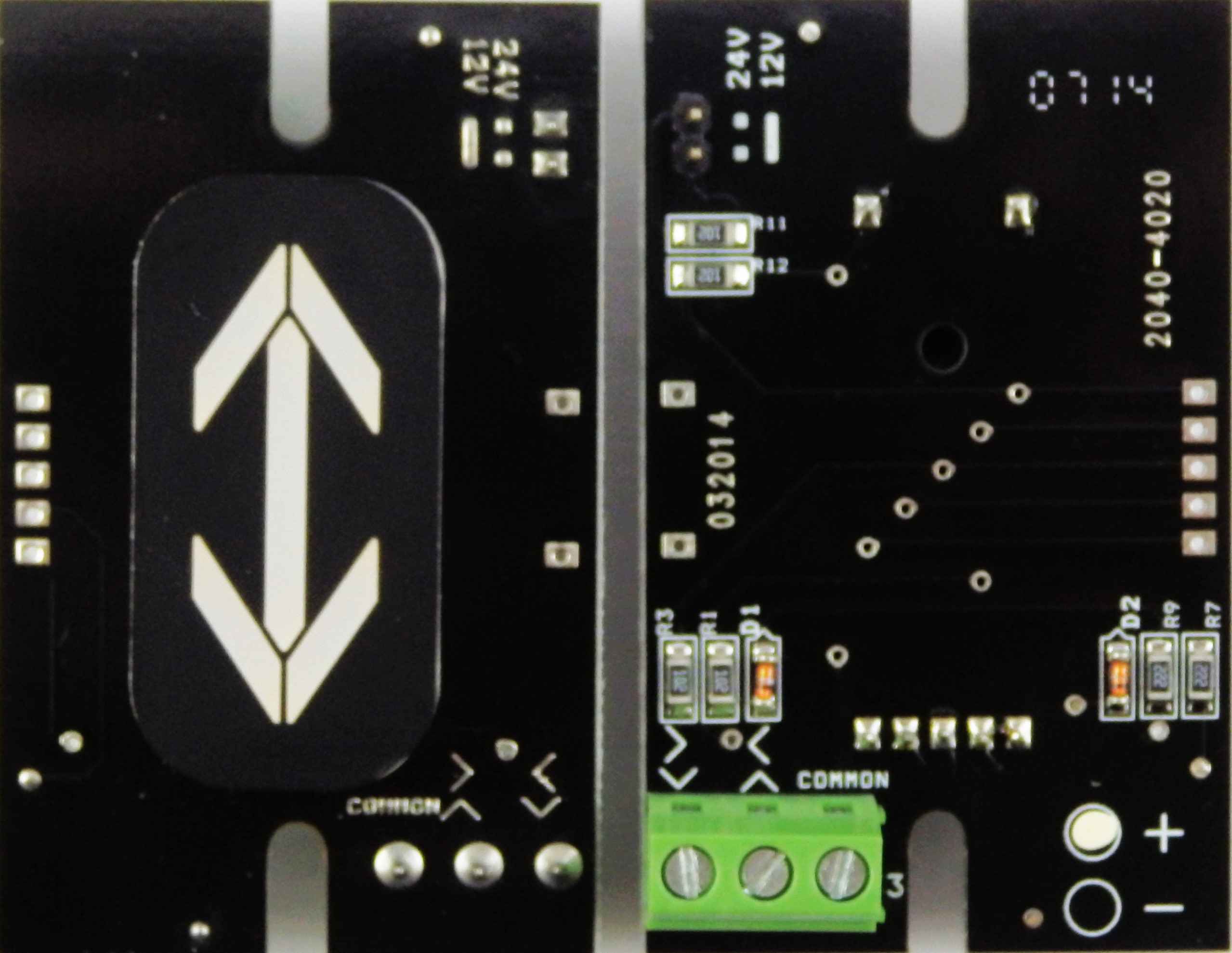

So i am trying to upload an image of the display that has to be powered and the preexisting board on witch it mounts but i cant at the moment i ll try again later .
The project is an upgrade of this existing board witch is feed by an external supply witch provides it with either +24or-24V it is used in elevators . The reason i want to know how to reverse the polarity is so i can create the circuit in order to not need a different board witch it does at the moment. it uses either +or - as common .
So i dont need to make different ones i want to take the polarity that i am given and always make it for example possitive
For example this is an other one i need to upgrade as you can see it has 3 "pins" 1 is common witch is either possitive or negetive voltage and the other ones are for the direction of the arrow . I want to replace the common pin with 2 others 1 receiving negetive and one receiving positive voltage so it works either way.
That is a very different application and not one that needs a dual-polarity power supply to work?
According to the description, the arrow LEDs work on either polarity.
If I understand what you are saying, you want to use two wires and have one arrow working on one polarity and the other with the opposite polarity.
I think that should be possible just by adding two rectifier diodes from the two inputs to common, both the same way around (eg. both cathodes to common or both anodes to common).
You should then just be able to use the other two terminals and the lights should be controlled by the power polarity.

Also they are two boards 1 for positive common and 1 for negative i reverse the diodes in the input for each one.
If you have a processor or some electronics on the board then you can use a bridge rectifier to supply it with a constant polarity regardless, then you could detect the polarity of your signal using either a couple of transistors or a couple of opto isolators back to back.

So most of your ideas are pretty helpful but the problem is i want something compact because on most of the designs i want to upgrade i need 6 -12 inputs inverted if you go on my page ( https://www.sheltek-electronics.eu/lift-electronics )and see those codes DT404627ABCD or DT404627ABCD you ll see i need almost every input to be reversed therefore i cant have a big support circuit .

The ABDC and arrows are the inputs the outputs go straight to the display not used elsewere
I am trying to improve existing designs so i dont have to assemble 2 different boards as i do at the moment.
Why not just put a bridge rectifier around each LED, so the whole thing works regardless of polarity?
That would be far simpler and cheaper!
You've got a processor in there. Fit a bridge rectifier on the power input. Label the power inputs "Gnd" and "Supply". Measure the supply (before the rectifier) and if is -ve, get the program in the processor to invert all of the 6 - 12 signals.
