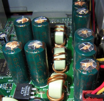

Here is a picture of some bad capacitors.

If an electrolytic capacitor has bulged its end and is leaking, like in the picture by LandonRobinson, then it is definitely faulty and should be replaced.
However it is quite possible for capacitors to have dried out and lost capacitance over the years and still not show any outward signs of distress. In those cases the only thing to do is to measure their capacitance and or their ESR (Equivalent Series Resistance).
If the ESR has gone high then the capacitor will perform badly.
To measure ESR, you need an ESR Meter (obviously!) or you can use an oscilloscope and a function generator.

i've looked but found no schematic. however, since it's a switcher, the first thing to look for is dried out electrolytic caps, as they cause 95% of switching supply failures. they might not be as obvious as the ones pictured above.
