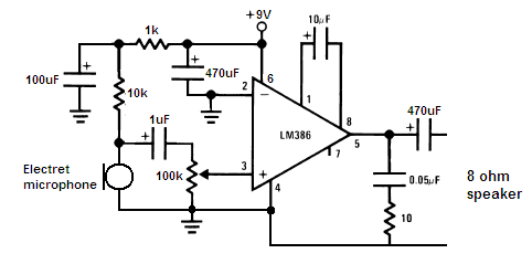

An amplifier IC is the easiest, probably the cheapest and works the best.
Many people start with the LM386 power amplifier IC. It provides about half a Watt of power to an 8 ohm speaker with a 9V supply.
how can I figure out how much power I should provide to the microphone?
Microphones don't have power provided to them. An electret mic needs 0.5mA of current, not power. The speaker gets the amplifier's power provided to it. The loudness of the speaker is caused by the amount of power from the amplifier. If the power from the amplifier is too high for the speaker then the speaker will break.
how do I figure out if my microphone is electret or otherwise?
If it is slightly bigger than a pencil's eraser then it is electret. It will have two wires, one connected to its metal case which is ground in the circuit. The other wire gets a small positive DC current from a resistor and is its output.

yes, you can do this to increase the gain if necessary. You may want to breadboard the circuit above to see if it is adequate before adding the TL084.

The 386 design Audioguru shows should be fine without preamplification as the 386 is set up to have a gain of 200 (increased from 20 by the 10uF cap between pins 8 and 1).
Here is the datasheet for the part. Although the half watt or so of power will produce a respectable sound level (a little higher than talking level without much distortion and with a reasonably efficient speaker) you may want more power depending on your application.

The TL084 is a useful part to have, but shouldn't be totally needed in this application (unless you need very high sensitivity). I edited my previous post btw after realising it was the 084 you wanted. Still not sure if there is a lead on it though.
You don't need a quad op amp (TL084). Try finding TL071 or TL081 (single), or TL072 or TL082 (dual).
The LM386 schematic I attached has a voltage gain of 200 which is plenty of gain. So an additional preamp will not be required.

The LM386 amp has a voltage gain of 200 which is a lot. An opam has a low frequency voltage gain of a few hundred thousand or a wideband voltage gain of about 300. Two cascaded give a wideband voltage gain of 90,000 which is so high that they will just amplify circuit noise.
what the heck does all that stuff do (the components in the circuit you posted)? More specifically as an example, why are there so many capacitors (I counted 6) and what specifically do they do in this circuit?
1) The 100uF cap filters the supply for the mic so that feedback doesn't occur.
2) The 1uF cap allows the mic to have its own DC voltage and allows the input DC voltage of the amp to be at 0V, and passes the audio.
3) The 470uF cap bypasses the battery and keeps a low impedance as the internal resistance of the battery increases as it runs down.
4) The 10uF cap increases the gain from 20 to 200.
5) The 0.05uF cap couples the 10 ohm resistor from the output to ground without passing the DC.
6) The 470uF output cap couples AC audio to the speaker but not DC.

The internal resistance of the battery increases when the battery runs down. Then the supply current changing in the amplifier when it is pulsing into the speaker causes the supply voltage to jump up and down. Then the whole circuit starts to jump up and down making a "put, put,put" sound. All battery operated circuits should have a supply bypass cap to supply peak current pulses when the battery can't.
One specific question though, theoretically, could you remove that capacitor and just connect pin 2 to the negative terminal (ground) of the battery without drastic consequences?
Pin2 is already connected to ground which is the negative terminal of the battery. The battery's voltage will jump all over the place without a bypass cap.

The speaker is an inductor. Inductors have a high impedance at high frequencies. The IC is designed to work with an 8 ohm load and goes crazy if the 10 ohm resistor is not its high frequency load. The 0.05uF cap couples the AC without passing the DC.
Erm, what? :eek: There's that couple word again :(. Does that mean the output from the amplifier is AC? Or..?
A capacitor couples an AC signal from one stage to another stage, or sometimes from the output of an amplifier to a speaker. Couple also means to pass.
One general question covering all of the caps is this- why those specific sizes? I suppose the 1uF makes sense, but what about some of the others? Is it about the time it takes to charge them?
A capacitor has impedance which depends on its value and on the frequency. The impedance of the 470uF output capacitor at 100Hz is 3.4 ohms so most of a 100Hz signal will go to an 8 ohm speaker, but at lower frequencies the cap will have a higher impedance and less lower frequencies will go to the speaker.
