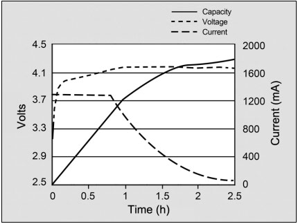

The slightly larger than AA LiPo cell called the 18650 cell available on Ebay or anywhere is possibly the best secondary battery match for the 3W LED. It is a bit higher than the primary Lithium Cell of 3.0
https://www.sparkfun.com/products/12895
The simplest solution is charge with PV to 4.10~4.15 then stop charging by turning on the LED
When switched the LED is selected on a different connection to the battery as the voltage will drop when the charger has reached full charge.
We will use only a carefully selected Diode and R for both functions.

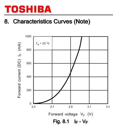

This LED response is only spec'd at 25'C which will lower in voltage as it gets hot. Heat loss must be mechanically design to reduce the heatsink resistance to <30deg C per Watt.
I won't get into details unless you show some thermal design understanding.

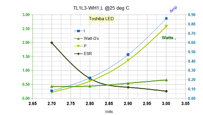

  • n.b. I chose 2.90V where junction is saturated and fairly linear above this , which is almost 50% of the Absolute Max current and power of the device.
    Vth = 2.710 V , ESR = 0.400 ............ (3)
  • resulted iin error <1.8% in Vled
my error in digitizing Toshiba graphs ~1%
calculated Vled from (2) using (3) and I only.
V I ESR P Watt-Ω's Vled Error
2.70 0.08 2.00 0.216 0.43 2.742 1.6%
2.80 0.22 0.71 0.616 0.44 2.798 -0.1%
2.90 0.47 0.40 1.3659 0.54 2.8984 -0.1%
3.00 0.86 0.26 2.583 0.66 3.0544 1.8%
At the risk of being too verbose or too brief, do you follow my points yet?
