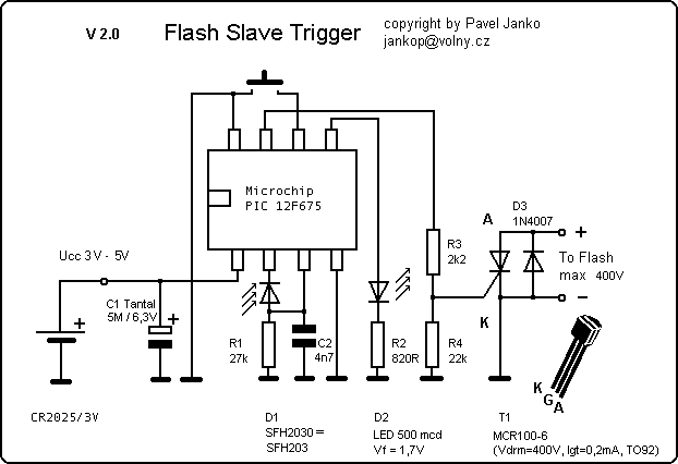

Rolf, Have You seen This Remote Slave Trigger? It looks simple enoff. He dose have the "hex" code on his site, but not the source code. As I realy like to add a Daylight sensor to this.

Thanks for the link. So it counts pulses. This is what I am trying to get around; after we did some testing and found our two cameras fired different number of pre-flashes under very similar circumstances.

No, what I want is for the slave to fire when the cameras main flash goes off (the last flash). Then the cameras setup will be unaffected by the slave. It will be used mainly for filling in background when taking pictures in large rooms. Or when taking portraits, as the main flash, when the camera flash will be used in the bounce mode. Used this way, the exposure should be OK.
This could be achieved with a time delay that blocks any triggering for about 50mS (I think all pre-flashes occur in this period), when this delay times out the cameras main flash (last flash) would trigger the slave. After about 300mS the unit should reset.

This output circuit works fine, with my Vivitar 2000, that have a trigger voltage of about 102v. The SCR (MCR100-6) is rated at 400v and the gate resistor is 10 K. But some commercial strobe units have trigger voltages well above 300v and that makes me a little nervous. I don't have a HV variable power supply to test this and I don't have a lot of room on the PCB for an optical isolator circuit.
The IC is a 4011 operated on a 3v supply.
Any ideas?
Why optoisolator?
1. All flashguns have very high voltage internaly on flash capacitor!
2. Thyristor MCR100-8 has Vdrm = 600V

I am not sure voltage on the capacitor is necessarly the same as the trigger voltage. So I don't think this has to be factored in.
So you would feel save with my circuit at trigger voltages up to 400v? Like I stated I have not found any unit with a trigger voltage over 380v.
Thanks Nigel, I wasent sure, maybe I was worried about a catastrofic failure of the SCR.

1Stevo brought my attention to Povel Jenko's PIC slave flash trigger (see his post) and it works great. His (DIY) design (noting for sale) but the schematic and HEX code is poster here:
https://www.fancon.cz/slave-flash-trigger/slave-flash-en.html

This is what I ended up with by using a PIC and a much simpler circuit: https://www.pbase.com/sinoline/pic_ii
I used the design from Pavel Janko (the image included in one of the posts already), but changed the photodiode to a phototransistor.
The unit works exceptionally well, with the ability to "learn" the pricipal camera's flash pattern, and only triggering the slave flash on the main (shutter-opening) flash.
