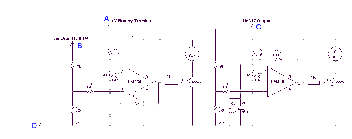

Jason,
This is about as close I can get with the present circuit and information.
Look thru it, it hasnt been tried but it should be OK.:)

I see in your new schematic that the power of the LM358 now comes
from the LM317. This is what i have been saying all along, and i
even thought this was the way it was going to be from the start.
Just one quick question now...
What does "Junction of R3 and R4" on the schem mean?

hi Al,
Its where resistors R3 and R4 are joined together. ie : point 'B' on the dwg.
Hi Eric,
Oh ok i see now...that is a reference to the 'Existing Circuit' diagram.
It was a little confusing because there is an R3 on the new schematic too,
and there 'was' an R4 previously too, which i guess the 1k's can be called
now.

MrAl: Thank you :) I was actually going to ask all of my questions for Eric or yourself later on (I have a small list, haha) once we get my initial problem solved. I am still testing Eric’s circuit under different scenarios to see how it behaves, and how (or if) it affects any other part of my existing circuit.
Hi Eric :)
I have been testing the circuit based on your latest schematic. I am still working on it, because I want to see how the whole system behaves overall under certain scenarios.
Last night one little thing was bugging me (one connection), so I made a very minor change, and so far it has been working better. I was prompted to remove the potential divider connecting to the R3/R4 junction (point “B”) and connect it to the junction of the two diodes instead. It definitely made a difference. **But**, I think it may be due to the lack of charging current for the battery, in which I was hoping you would shed some more light on… I just don’t understand the theory. I thought it was just R=V/I ??
Once we sort out the charging current issue, I will definitely re-test it with your original connection (back to the R3/R4 junction).
Other than that, I connected everything else like you said, and so far so good. The RV1 pot definitely requires “fine-tuning” I must say, so I have hooked up a 25-turn cermet trimpot… a lot better than a standard one.
Eric I don’t expect you to “re-design” my circuit as per MrAl’s kind suggestion. It’s working ok… just needs a few minor adjustments here and there as you previously mentioned (thank you for your advice) but not fully discussed.
I think you didn’t like the Charging LED operation, the charging current, and the 12-volt reg. I think I’m just going to eliminate the 12-volt reg and that’s it, but have a fuse connected in series with the Load output. Unless you have a better idea?

hi Jason,
I used a multiturn pot to set RV1/RV2, I find the single turn pots are too coarse for comparators.
I dont mind anyone doing a pick and mix of my circuits, if by modifying it in anyway gets it doing the job for you, thats fine by me.:)
The reason I was concerned about the apparent low charge current etc, was the recharge time of the battery.
Ideally you want a float/standby battery back upto full charge asap.
You never know when the next mains out will occur.
I think the diode in the output of the battery when powering the LOAD is inefficient, you are losing 0.7V across this diode and all its doing is shunting the 39R current charge sense resistor so that the charge LED can light.
I would suggest a relook at that part.
Lets me know how it goes and if you want any areas reworking.
Just lets get the show on the road.;)
BTW: increasing the 1M0 feeback resistor will reduce the dead band [on/off] and likewise decreasing it will increase the dead band.
You may need to tweak the RV1 if you change the 1M0

Yeah I need to consider another solution for the incorrect battery polarity protection. I got the idea of the diode off another schematic, and did notice the 0.7V loss... I thought I'd have to live with it. I will definately come back to that one... thanks!
As with the 5-watt 39R - based on your previous post - I was looking at a 4R7 instead. So then 0.31A would be the max (1.5V/4.7R=0.31A), better?, assuming the lowest voltage before it became 'isolated' from everything is 12V. What you think? Battery isolation will be something I'll need to add on, but one thing at a time.
I'll also look at the 1M resistor. I'll see if I have a 1M trimpot somewhere that I can add it series to the current 1M - see how I go :)

hi Jason,
Been hanging back, following your other reverse battery protection thread, waiting see which you have decided.
I did look at the charge indicator upstream of the LM317, but IIRC you did have the 12V reg on the output side of the LM317.
Where are you taking the LOAD current from, when the battery is charging and also when the battery is powering the LOAD.?
The relay method is the I have used for rev/pol protection,
its also possible to drive the relay by a transistor and use base control, it gives more flexibilty.
