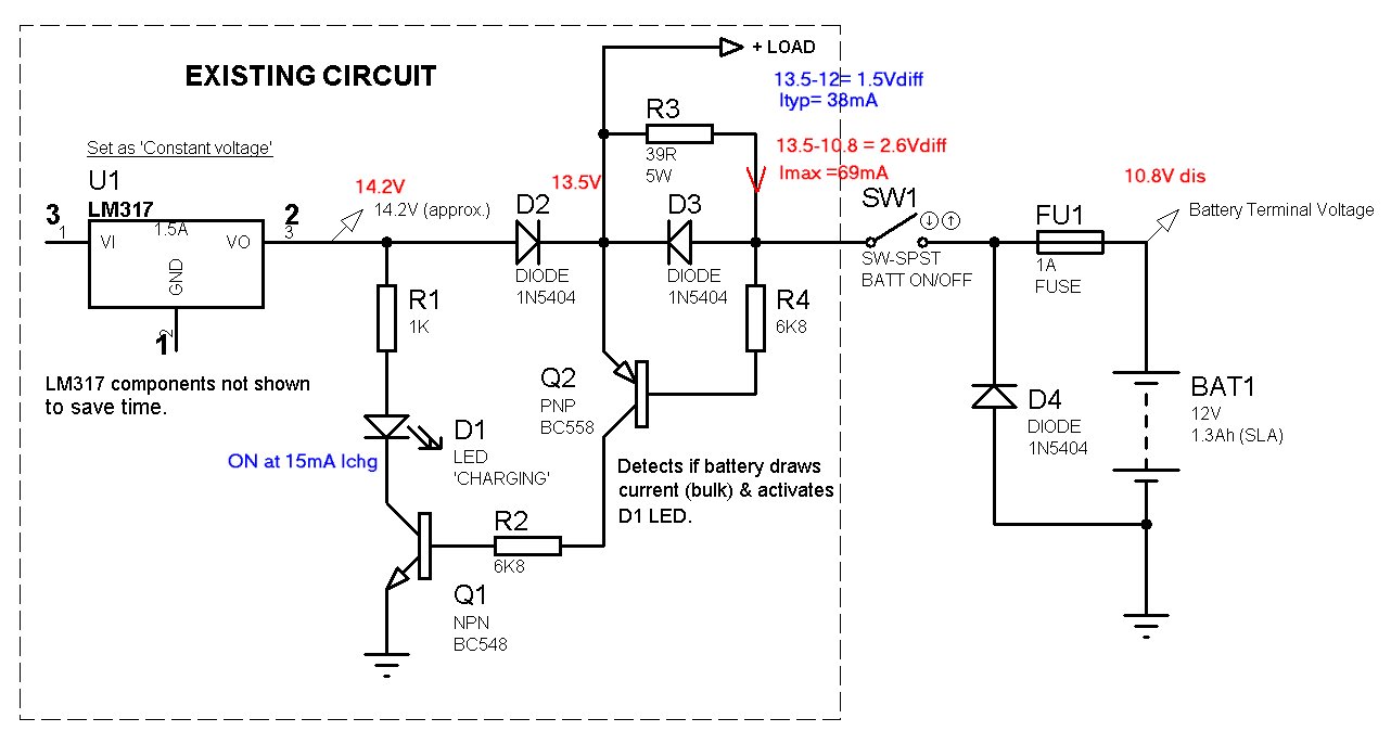

When I initially put the circuit together, I had already removed the R4 for the LM358 as I thought it was not needed. I also knew about the missing resistor for the base of the transistor (I'm using a BC548 instead of 2N2222 by the way)... but thanks! I haven’t yet tried your ‘diode’ suggestion though.
Guys, I cannot replicate! Maybe I’m having a blonde day, but this is starting to do my head in! Perhaps I don’t understand the diagrams, or maybe it’s because you haven’t included a battery when you were testing it (which could explain why I’m having problems).
I was kindly wondering if you could do another schematic and this time include my fuse/switch/diode/battery setup and show me how you wire up the LM358 to it, and also the LM317. It sort of works and it sort of doesn’t??
A couple of questions for you:
1) I really don’t understand why I need to connect the LM358 power pin to the battery and not to the LM317 output. Connecting it this way is causing problems… If you observe my existing circuit (see attachment), the ‘Charging’ LED will come on thinking that the battery is drawing current when it’s not, when in fact it’s the LM358 drawing the current.
Also, multimeter shows a huge voltage drop because of this (I don’t like it!).
Connecting the LM358 to the LM317 instead eliminates both of these issues.
2) What is supposed to happen when say, the fuse blows? Is the buzzer supposed to turn on straight away? What if the fuse is replaced? Is the buzzer supposed to turn off straight away? Or do I expect a delay?
By the way, I have attached my existing power supply/charger schematic for you to observe.
Thanks again so much.
Jason.

hi Jason,
I'll have another look at the circuit with the part you have posted added to it.
You have realised that the LM393 is open collector output so the R4 is not required but a resistor in series with the BC548 is required. OK.
If you connect the LM358 power supply pin to the output of the LM317, if the mains fails then the circuit will not be active. Also R2 and RV2 will not see any voltage change if connected to the same point as the two 10K's [far left].
In other words the circuit will not be 'fail safe' in the event of a mains failure.
If wired as I understand it [ if the LM358 is powered from the battery] would appear as a 'disconnection' and the buzzer would sound, likewise if SW1 was opened.
What level of float charge current is charging the battery.?
The R3 39R seems to limit the current to about 50/75mA.

Quick look at your charger.
Just curious, whats the device that the 12V 1.3AHr SLA has to power.?
Anything up to the maximum the battery and/or charger can supply... heatsinks and everything taken into consideration of course.
I really have a 12V (3A) regulator connected at the Load which I've omitted out of the diagram to keep it simpler. Basically it could be an emergency lighting system (using LED's) or an alarm, or something like that. Many uses!
BTW, some of the voltage and current notes you wrote on my diagram don't quite look right (I am sure you know what you are doing and I respect you fully), but I am getting satisfactory results on my end, and have been testing it for a few weeks without fail. What the!!
You say you are driving a 12V 3A reg from the output of the 'circuit/battery',
how is that possible with a 12V battery and the LM317 set to 14.2Vout...:confused:
Well the LM1085 12V is a low drop-out one, so I can get close to 12V when the charger is working (as long as the load is not too small), but slightly less than 12V when the battery is in use... I understand I won't get 12V during mains failure.
The reason I have it there is because 13.5 might be too high for some applications (better safe than sorry), otherwise I wouldn't bother with it.
Do you have a better suggestion? :)

Guess what, I have some good news, I think. I just rewired everything, and it appears that I had a bad breadboard jumper/wire that snapped without me knowing... geez I hate it when that happens!
I am just testing it out properly at the moment before I get back to you and say Yay or Nay.
As with the charge current, as I mentioned in a previous post, I replaced the battery with a 7W globe with a multimeter in series set to tell me the current drawn by the globe, and it gave me a reading of just under 300mA (and my battery can handle initial current up to 390mA), so I'm not sure why you calculate it as being only 69mA :confused:
hi Jason.
First of all you will not get the same results using a lamp in place of the battery as a charge load.
Looking at your mv circuit.
The LM317 output is set tp 14.2V, there is a 0.7V drop across D2, so that gives 13.5V at the junction of D2/D3.
At this point the 13.5V will not power a 12V 3A regulator.
Now assume the battery is fully discharged at 10.8V [for a SLA]
that means there is a voltage difference of 13.5V - 10.8V= 2.6V across the 39R.
Ohms law, Ichg = 2.6/39R = 0.067A [ 67mA Max]
as the battery voltage rises to say 12Vnominal, there is only 13.5V -12V = 1.5V difference across R3 [39R].
So Inom = 1.5V/39R = 0.038A [38mA]
So for a 1.3AHr discharged battery, assuming an average charge current of 40mA, will take 1.3/.04 = 32hours at 100% eff, as the eff% is more like 60%, this means its going to take about 50hours to fully charge the battery.!!
Also the D3 diode will reduce the effective battery voltage from 12V down to 12-0.7 = 11.3V, which will not power a 12V 3A regulator.[LOAD connection]
BTW: the LM317 IIRC is rated at 1.5Amax.
The D1 LED charge lamp indicates CHARGING with currents as low as 15mA, which could be misleading.
Hope this covers your question.

OMG, this is confusing the crap out of me now.
*If* we connect the LM358 power pin to the LM317 *instead of* to the battery directly, like originally suggested, and make any other necessary adjustments, then the LM358 would still operate because it's powered from the LM317 - even if the battery has been taken away.
Please let me reiterate what I want, as there still seems to be some confusion (and I may be to blame):
- If the battery has been removed from the charger (intentionally or unintentionally) when AC is present, warn me**.
- If the fuse blows for whatever reason, when AC is present, warn me**.
- If the switch has been turned off when AC is present, warn me**.
- It does *not* need to warn me of any problems during an AC failure (to keep things a little simpler).
** It's to warn me that the battery has lost connection to the charger, causing it to self-discharge, and that the load will not be powered during an AC failure if the problem is not corrected.
Shall we start a new thread so I can explain it all precisely all over again? :( Sorry, I'm becoming annoyed over the whole thing now. *breath in; breath out Jason*
