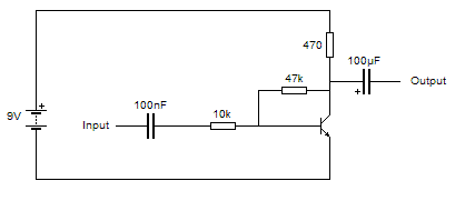

The attached schematic is a the simplist audio amp you can build.

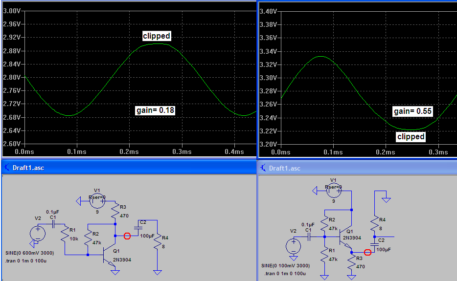

I simulated your small amplifier.
1) With an 8 ohm speaker, it doesn't have gain, it has loss.
2) It has a very small output power, a whopping 0.8mW. Headphones have much more power.
3) It is distorted.
I also tried it as an emitter-follower and its loss is less. Its output power is 0.2mW.
Of course it won't power an 8:eek:hm: speaker (I'm insulted you would ever think that I'm so much of a noob that I didn't know it won't do that!) but where did he ever say he wanted to do that?
He just said he wanted an audio amplifier and this circuit will do just that.
He didn't say what gain he required, so I just designed one with a gain of 4.7.
I was proving a point, if you make a vague request then no one wil be able to give you what you want.
Alright then with a transistor Hfe of 100 the gain will be 4.489, an error of only 4.489%!

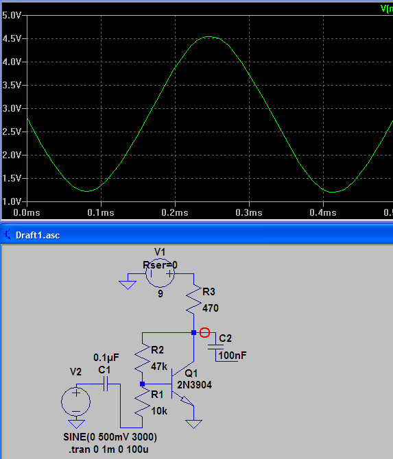

My sim of the single transistor amplifier without a load shows a voltage gain of only 3.35.
Why so low?
The simulation must be wrong, either that or the transistor model you used has a gain of a lot less than 100.

I used a 2N3904 transistor in the sim with a typical current gain of 230.
I also tried a 2N5089 that has a typical current gain of nearly double and the Q-point shifted towards saturation but the voltage gain increased only a little:
I can't make the attachment.

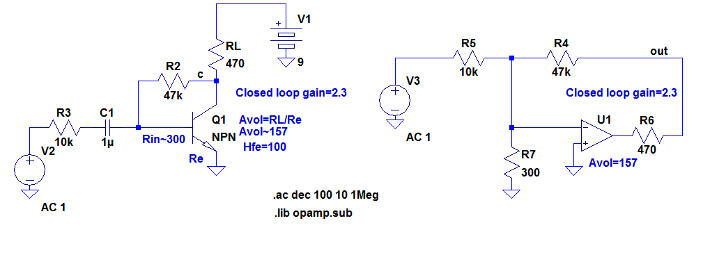

Wikipedia uses the "beta" symbol for "feedback factor". I don't think "current gain" affects voltage gain in a transistor circuit.
The open loop gain of the transistor is actually Rload/Re. Re is .026/Ie. Ie, for a beta of 100, is about 8.72mA. This makes Re=3, and Avol=157. However...
You forgot about Rin which is approx. Re*Hfe, or about 300 ohms. This is significant. I'll let you do the math, but below is the transistor amp and the equivalent circuit. The gain of both is 2.3 in simulation. With a 2N3904 in the same circuit, I also got a gain of 3.35. The higher beta lowers the collector voltage, increasing Ie and reducing Re. This increases Avol, which helps a little in this case, but Rin increases by a factor of 2 or more, which helps a lot.
