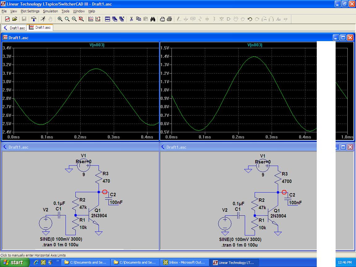

That circuit is a shunt-shunt amplifier and I expect that the low cut-off frequency is quite high for an audio amplifier (unless you increase the input coupling capacitance). The input impedance is low because the feedback decreases it. It is useful when you want a low input impedance.
The closed loop gain is a 'trans-resistance' and it depends on the current gain of the transistor.

I suppose the only way to get a gain of anywhere near 4.7 is to use a darlington transistor like the MPSA14. One advantage of this circuit is the output impedance is much lower than Rc which isn't the case with a normal common collector amplifier.

Does this little amp need such a low output impedance? Why don't we just bump up RL? The current in the collector at the moment is so large that our feedback resistor cannot hope to source enough current to the base. OK, you could up the beta with a darlington pair, but I think a collector resistor of 4k7 should improve the gain a lot.
I changed the collector resistor from 470 ohms to 4700 ohms. The DC operating point of the collector changed but the gain didn't change much. It was about 3.3 and it increased to only anout 4.5.
Actually, with a beta of 100, the ratio of Rfb/RL=100 sets the collector voltage at approximately (Vcc+Vbe)/2, which is close to ideal. With higher beta, this voltage will be lower.
Yeah, and look at the new DC operating point.

Since the theoretical voltage gain of this amp is 47k/10k (for very high transistor beta), 4.5 is a much better performance than 3.3. 30% better. I wouldn't call going from 3.3 to 4.5 "not changing much". I'd rather call it "just about right".
And let me guess - the operating point was closer to 0.7V? For a better operating point (about half the supply), insert a 7k resistor from base to ground. That should do the trick, but I am guessing. And I'm also guessing that this is not a very linear amplifier for large(ish) swings. I do like the simplicity of it though.
I agree with you about the gain, but I wouldn't call 0.7V (~0.95V, according to Audioguru's waveform) a good operating point.
The transistor with the 4700 ohm collector resistor was biased with a 4.5VDC collector operating point when an 8.2k resistor was connected from its base to ground. As usual with a common emitter transistor without a current source for its collector load, the top of the waveform became compressed at high levels and got as high as only 8V with the 9V supply.
