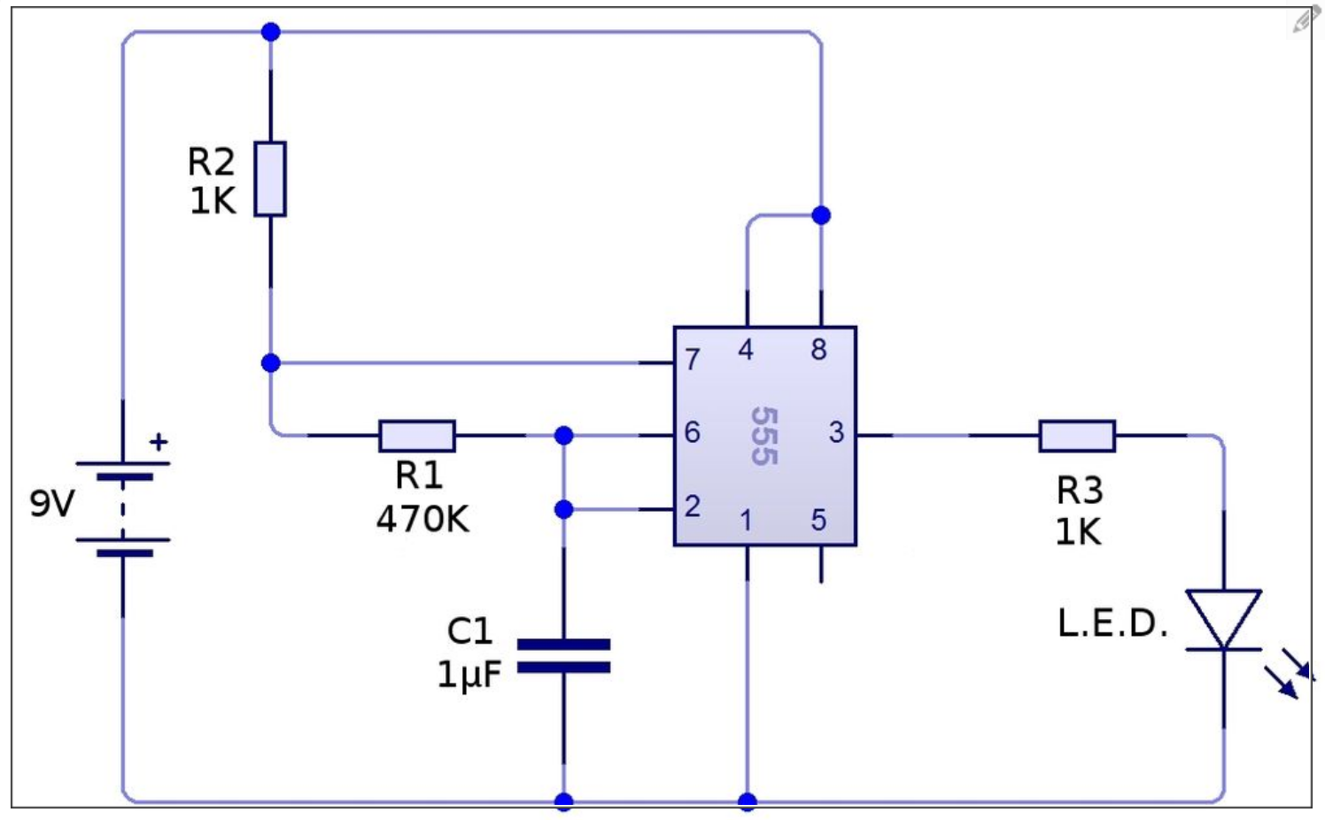

Single Led Flasher Circuit.

This will work fine over a range of voltages, just with some variation in LED brightness.
It should have a reasonable size cap across the power connections (10uF .. 100uF) and also really have a 0.1uF from pin 5 to ground (0V), though in practice it probably won't make much difference.

Post a link to the circuit, and post a picture of how you've built it - just saying it "doesn't work" isn't of any help - there are non-working circuits out there, but it's more likely built wrongly.

Just add another LED and resistor between Pin 3 and positive power.
The two will alternate as the output pin swaps between high and low level.

If you are having trouble with soldered circuits not functioning, you are probably overheating the components. I have toasted many a transistor and 555 back in the day when I first started tinkering using an iron that was WAAAY to hot.
