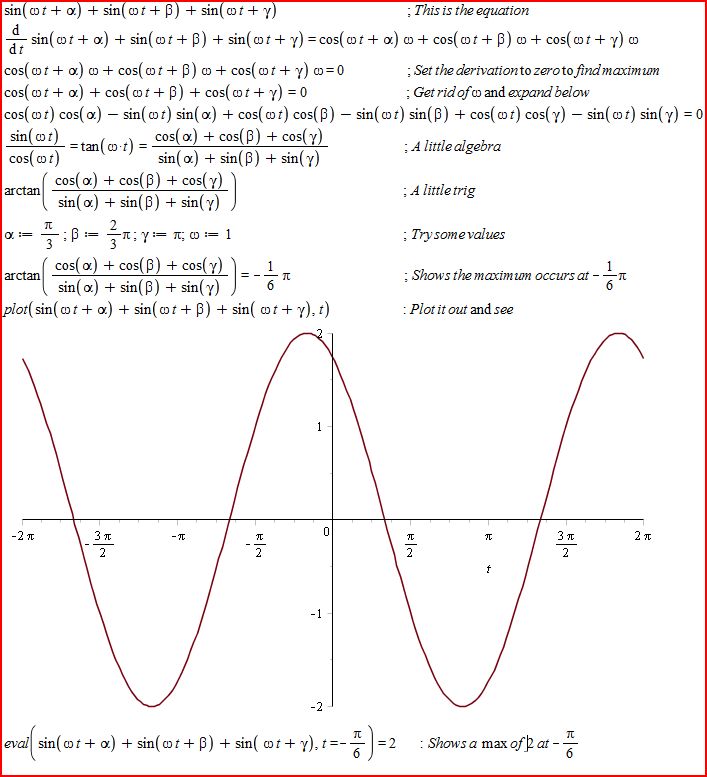

1 master fixed frequency sine wave ~ 1 Hz split into three (assume splitter has no loss). Each of the 3 outputs of the splitter come with a different known phase shift from this master, but will have a same fixed frequency and amplitude into a summing circuit .
I need to work out (given their known phases to the master reference signal before they where phase split) where the peak occurs with reference to this master signal in time. i.e. its phase. Then (and I can do this) work out the max output signal at this point.
I need the simplest of methods.

WTP Pepper,
No matter how many sinusoids at whatever phase you add together, the result will be another sinusoid at the same frequency with a different phase. I understand you have three sinusoids, each at the same amplitude and frequency, but differing only in phase. The attachment shows how to calculate the phase where the max of the resultant will occur, and its max value.

To all,
Yes, anything that adds up to zero on the denominator of the arctan above will result in a zero magnitude.
