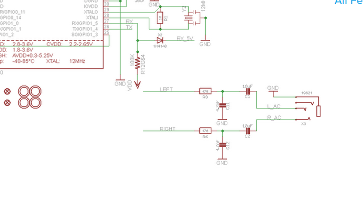

You can get playback modules. This one is WAV/OGG but that shouldn't be a real problem. It's simple to use.
https://www.adafruit.com/product/2133
If you use an arduino to trigger them then you can just use the same audio file and stagger-start them precisely it at different times instead of shifting your audio beforehand.

These modules don't require programming...you apply a trigger signal and off it goes and you plug it into the USB on your PC and drag files onto it. Did you even read the web page? The fact that it's not programmable or scriptable is it's selling point. There is also a tutorial links on the page.
Also, these modules are stereo:
There is also a 16MB version if 2MB is not enough space:
https://www.adafruit.com/product/2220
and a version with a built-in speaker amp:
https://www.adafruit.com/product/2210

Nope, they just flat out have a single trigger signal for every audio file on the module. Give it a read...it's what you're looking for.
My original Arduino comment was just if you wanted to have it do the synching for you (like if you wanted to have them do the same thing but at different points in time.) But all the Arduino is doing pulling the trigger line to ground to fire it. So if you connect all the trigger line from all modules together and pull it low, they will all start.
