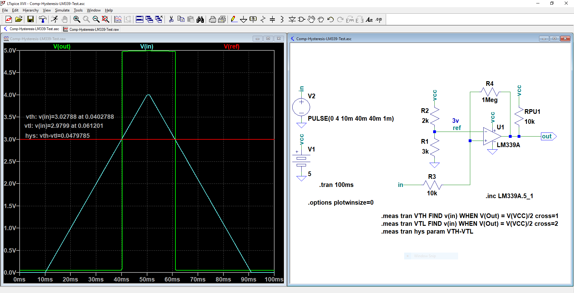

Hi, Anyone know where I can find a simulation model for lp339 or lm339 to work on ltspice? Tina-ti spice models do not work on ltspice because the software is different.

This TI model does work in LTspice. Downloaded from TI web site.

LTspice works with PSPICE models. So any PSPICE compatible models should work. There are other models available, but these are incompatible
Here's one, I use it and works perfectly. Can't remember where I got it from.
Add an Op-amp, change the "Value" field to LM339 and add a ".sub LM339.sub" directive.
You can use LM339_DIP14 if you want all 4 op-amps.
