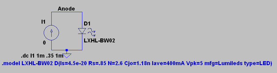

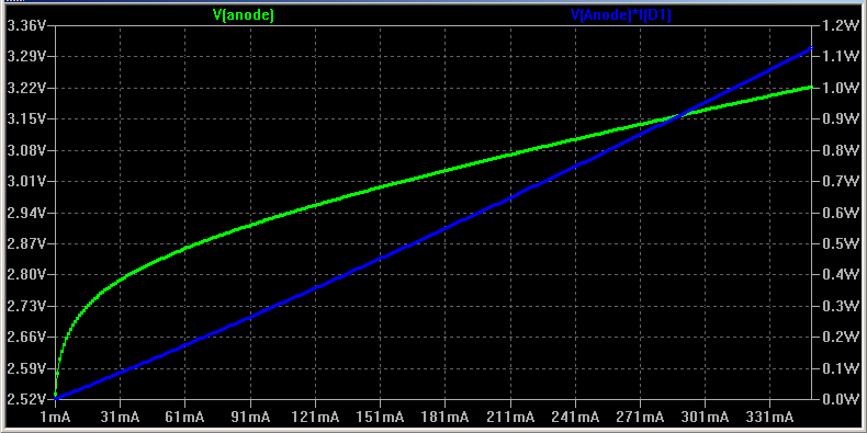

Here is how LTSpice models a similar Lumileds LED:
