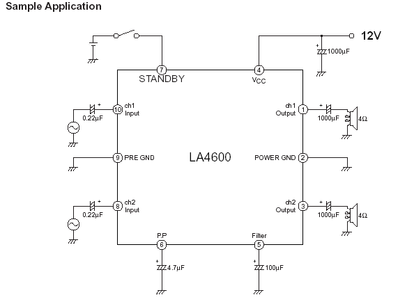

I assume your power supply is able to output 12V/1A. You need to check the output current. Try LA4600 which is a 4Wx2 channel excellent audio amp that can be done with a very few external components. You need 5or10W/4ohm small size woofer+tweeter pair or wholerange speakers for this to set up well.
I found digikey/mousers doesn't carry any Japanese IC's. However let me search it for you in US availability.
LA4600 Sanyo Original IC
All depends on your pocket :)..

Here's the circuit of LA4600(Sanyo Semicon), costs $1.29 from MCM|LA4600|SANYO IC 10-PIN SIP | Newark.com.
Lots of versatile chips are hidden out there.
