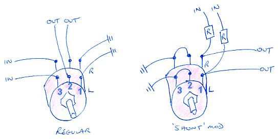

Also, I'm not sure exactly how to go about adding a volume control. If I just added a potentiometer, wouldn't the changing resistance alter both volume and pitch?
You need a stereo pot(with 6 terminals) if you're using TDA2822. In that the center terminals(wiper) is the output that going to IC. It won't alter any pitch.
