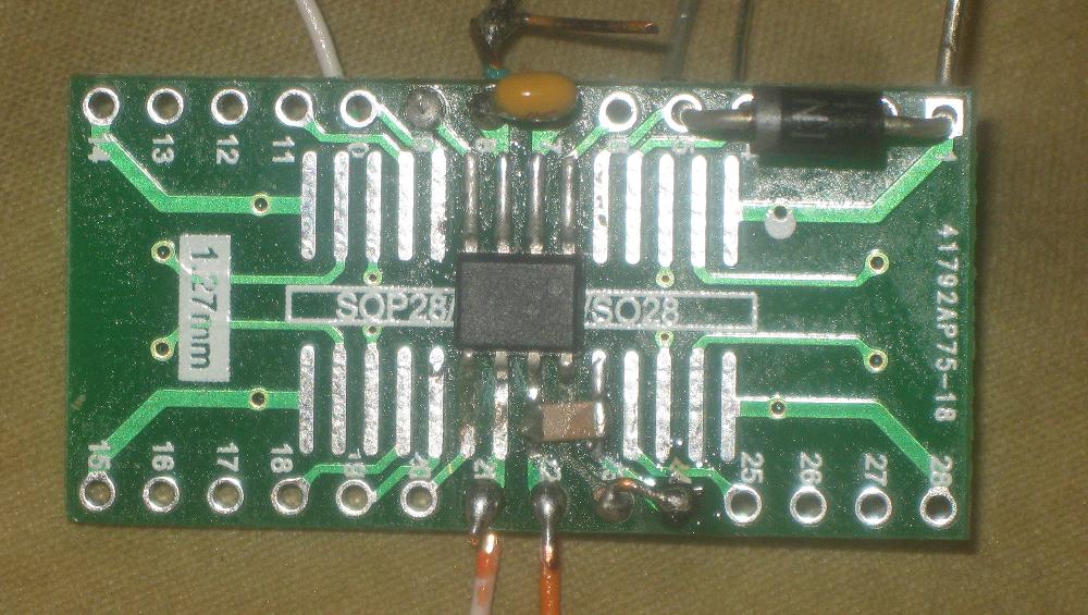

I tried the 'trick' this thread was about a little while ago with an 8 pin SMD package and 1206 size capacitor.
I pushed out about a 3/4 inch strip of the paste maybe came out to 1/8 inch diameter. Let it sit for one hour uncovered, as i had something else to do anyway. Seemed to work just the same as by letting the whole tube stay out for 3 hours. I did not notice any difference in the way it spread or the way it melted and formed into shiny solder and sought out the pins and pads.
There was a question of maybe some extra moisture, but i can tell you once you hit it with the hot air any extra moisture would boil away quickly. If it does affect the joint, i cant tell as there is nothing apparent that is different from doing it the normal way. Funny i only used about 1/4 inch of that strip of paste as it takes to very little to solder one 8 pin SMD chip and one tiny 1206 capacitor. I used a 28 pin SMD to DIP surf board and found that the capacitor terminals align nicely with 0.1 inch spacing pads so it bridges nicely over one 0.05 inch spaced pad.
I'll try to post a pic in a minute or two.
Ignore the spots that is not solder.
