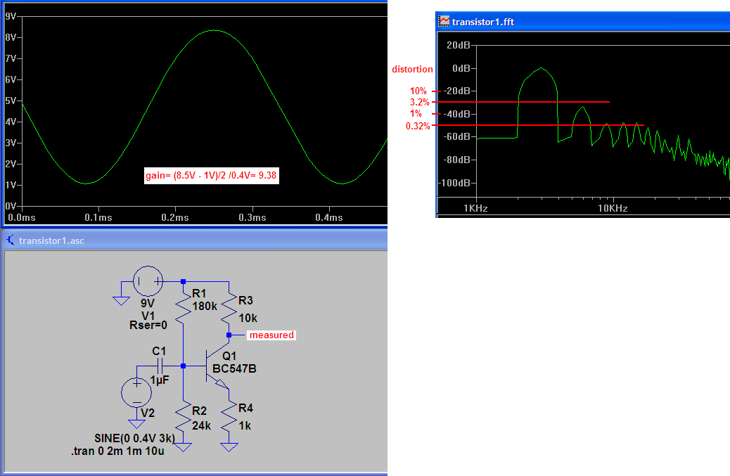

I don't understand your simulation.
Where does "negative feedback" come from in the 2nd sim? Is there an off-circuit connection we can't see? It looks like you just removed the emitter capacitor. Please explain the feedback mechanism (in your simulation, not in general theory).
And while it looks reasonable, how did you come up with those distortion figures (40% and 3%)? Did you run a FFT analysis on both sims? or did you just look at the waveforms and guesstimate them?
Also, the voltage sources are different (25mV vs 460mV) by more than a factor of 10; why is that? shouldn't we be comparing apples to apples here?

The unbypassed emitter resistor provides lots of negative feedback and it reduces the gain from about 180 with no negative feedsback to 10 with negative feedback.
An experienced guess. Most half-decent amplifiers have a distortion of 0.05% or less.
Negative feedback reduces distortion by cancelling most of the signal which reduces gain and reduces distortion. A TL07x audio opamp has a distortion of 0.003% because the negative feedback reduces its open-loop gain of 200,000 times to 10 times.

Have you seen how much distortion is caused by a single transistor without any negative feedback and at high levels? The distortion compresses the top of the waveform so much that you cannot see how much voltage gain there is. That is one reason that opamps have so many transistors.
I understand you tweaked the simulations to make a point, but I make common emitter amps like your second sim. Keeping Rc/Re to 10:1 or less, with no emitter bypass cap and 10:1 is plenty enough gain from a common emitter amp.
So when I said before "common emitter amp with no negative feedback" I was referring to something almost identical to your second sim. At least I think we're on the same wavelength even if not using the exact same terms. :)
To me "negative feedback" in an amplifier context specifically means feeding back some of the output signal back around into the input of the amp.
An unbypassed emitter resistor provides negative feedback to reduce the gain and reduce the distortion.
My simulated transistor with horrible distortion has no negative feedback because it has no emitter resistor and its gain is about 180.
If an emitter resistor has a value that is 1/10th the collector resistor then the gain is reduced to about 10 and the total distortion is about 3%.

Negative feedback is, in general, a signal from the output of an amp (or gain stage) that affects the input in a manner as to reduce gain and distortion.
It's perhaps not readily apparent but an unbypassed emitter resistor does provide local negative feedback to the transistor stage. The emitter resistor, in effect, creates a signal voltage that subtracts from the base signal voltage reducing the stage gain and also the distortion, the same as a separate negative feedback path would do.
The reason the emitter feedback reduces the output distortion is that the emitter current also flows through the collector load resistor (with the slight difference of the base current) and thus the collector and emitter signals are essentially equal in shape except for the gain caused by the difference in resistor values. Thus a reduction in the distortion of the emitter voltage (and current) reduces the collector distortion the same amount.

Your Li'l amp already has some negative feedback with the resistor from collector to base on the first transistor.
But for very low distortion you need lots of gain provided by many transistors then the negative feedback reduces the very high gain a lot and also reduces the distortion a lot.

But your definition of a common emitter amp with an un-bypassed emitter resistor as a "a standard common emitter amp (with no feedback)" is incorrect. A "no feedback" stage would either have the emitter connected to ground, or a capacitor across the emitter resistor to put the emitter at AC ground over the frequencies of interest. An un-bypassed emitter resistor does indeed provide negative feedback in the engineering sense of the word. Edit: The evidence of this is that it stabilizes and reduces the stage gain, and reduces the distortion, all characteristics of negative feedback.

Q1 in your circuit already has plenty of negative feedback through the collector-base resistor.
It has so much negative feedback that the distortion is fairly low at 3% (low for a simple and cheap amplifier) and the gain of the amplifier is less than 1 at 0.6.
This collector to base resistor provides Q1 with too much base current so its average collector voltage is low which reduces the max ouput swing. I showed a SIM of it clipping the bottom of the waveform in my post #9.
I showed the negative feedback coming from the output instead of from the collector of Q1 and I showed the collector resistor with bootstrapping which increases its active value for more open-loop voltage gain and it gives the NPN output transistor a base voltage that rises above the supply voltage for a higher output level.
