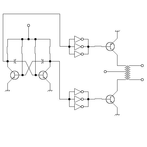

How about something like this? You can use the ferrite cores scavenged from a TV horizontal deflection xfmr. That ferrite is good to about 0.6Wb/sq M (Bsat) and will work nicely at 9.0KHz. Use CMOS HEX inverters as base drivers, and you won't have to worry about loading down the multivibrator.
fc= 1 / (2ln(RC))
