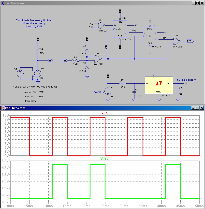

LTSpice is by far the best Spice I have ever played with, viz a viz crashes, convergence, initial solutions, etc. It has powerful plotting and waveform arithmetic, and great free support over on the Yahoo LTSpice group.
I just posted an example of what you can do with LTSpice in this thread on this forum.
LTSpice is by far the best Spice I have ever played with, viz a viz crashes, convergence, initial solutions, etc. It has powerful plotting and waveform arithmetic...
