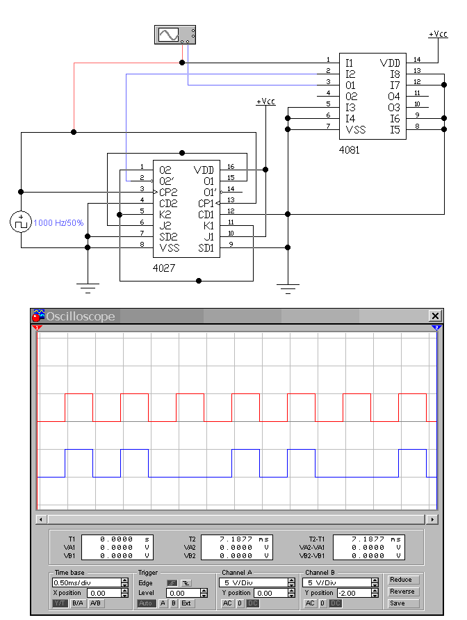

I'm putting in a I6 engine where the oringinal motor is a rotary engine that has a tach signal like a 4 cylinder.
So how can I make the stock tach work properly with the new 6 cylinder output?

I designed a board that does this for a 4 cyl to 6 cyl swap. It was pretty easy and was microcontroller based. All you really need to do is measure the incoming frequency then bump it up 50% and spit it back out to an N-FET with a resistor pullup to 12v. At least thats what I did.

Do you mean 6 cyl to 4 cyl swap? I would expect a 6 cyl engine to have a higher pulse frequency output (from the distributor I assume) than a 4 cyl, so I would think you want to reduce the signal frequency, not increase it.
If you want to build you own you could use a pulse swallower circuit generated by a divide by 3 flip-flop circuit and an AND gate as shown in the attached (CD CMOS ICs shown). The divide by 3 circuit is used to inhibit (swallow) every third pulse through the AND gate giving you the 2/3 (4/6) division you need.
Of course you will need to filter the power, and provide proper buffer circuits at the chip input and output to match the input signal and provide the desired output signal.
Yeah, you're right. I bumped up the period, not the frequency :) Little bit of difference between the two.
